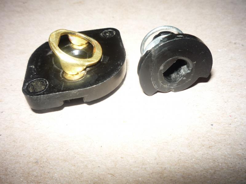

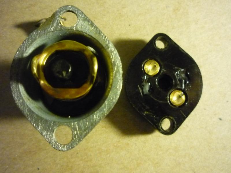

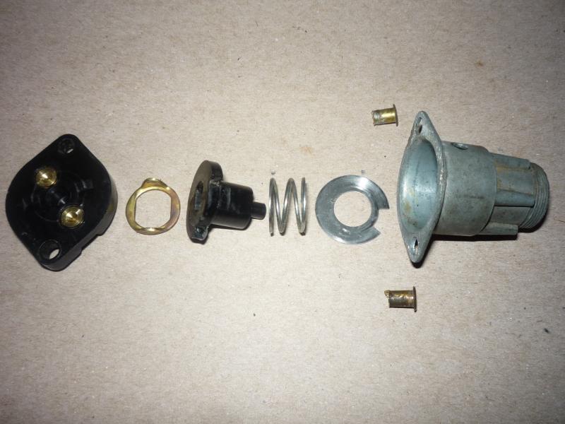

I hear ya about the ignition switch. I just spent several hours standing on my head removing the headlight and ignition switches, which had about a half ohm of resistance when there should be 0. I rebuilt both and after cleaning the brass contacts they work great. But placing the short bits of wire between the switches is hard to do with the switch panel in place. I didn't want to undo the choke cable, oil pressure gauge, etc to pull it out, although it probably would have saved time.
I was lucky and the ignition switch got to 0 resistance in the ON position after flushing it through with some CRC. Here is a spare ignition switch I redid after drilling out the hollow rivets. Everything was cleaned, repaired the broken stop plate, and put it back together. The Bakelite is too old to risk riveting it back together so I will use some plastic screws & nuts. Advanced Auto Wire has some great wiring diagrams on their website if you haven't seen them. Jeff
I appreciate the pictures and detail. Never have taken this one on, but after more testing, if it really is the ignition switch I am now much more confident about trying to clean and reuse existing. Thanks for the info.

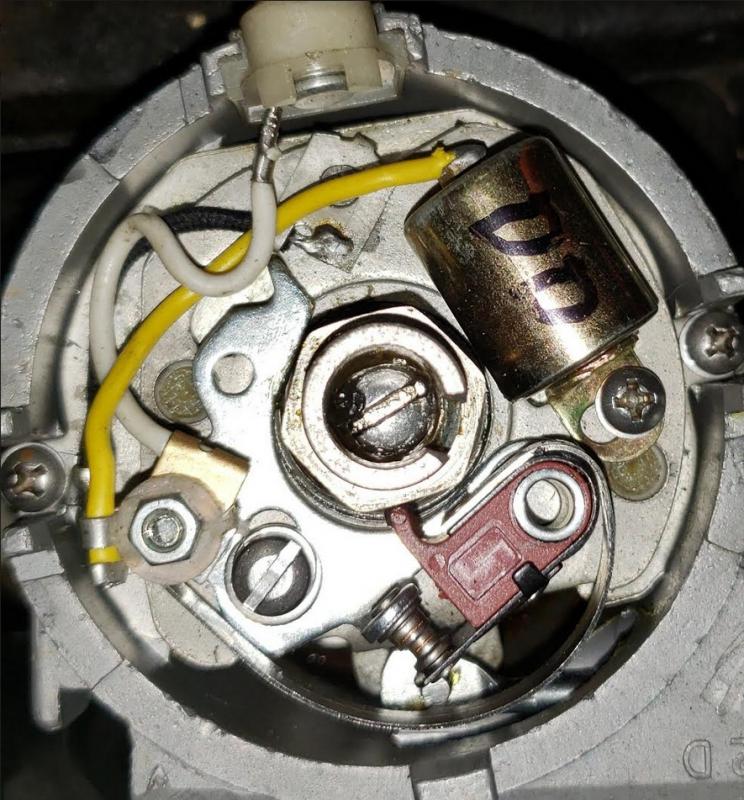

Did you check to see if the post on the points is isolated from the wire to the condenser? There's an insulating spacer that sometimes is the culprit.
Mickey
Agree & have experienced this. Remember the wires from the condenser & primary from coil must contact the spring to the points and all must be insulated from the spring pivot screw and nut. The spring is in effect a "wire" that goes to the movable point. The fixed point is grounded. Here one can see the two connectors are sandwiched between the nylon "hat" and the spring.
First off, great explanation and photo. I also had the experience of doing this incorrectly in the past. When I installed the new condenser yesterday, I used the approach you so well covered in your description. I will go back and recheck to make sure this was done correctly.
