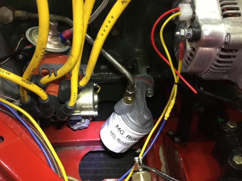

Your thoughts re the frame clearance are correct. The filter housing is the same for all the A series engines. However there are different extensions that fit between the filter housing and the block to provide clearance between the right hand frame rail.
See the pic of my setup. Note I am running an oil cooler so the pipe from the block to the filter is missing.

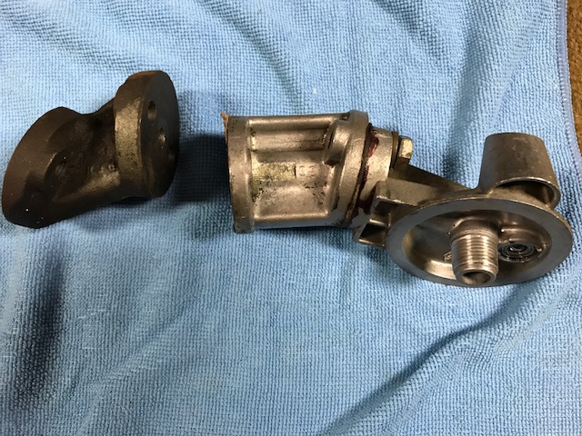

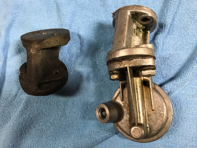

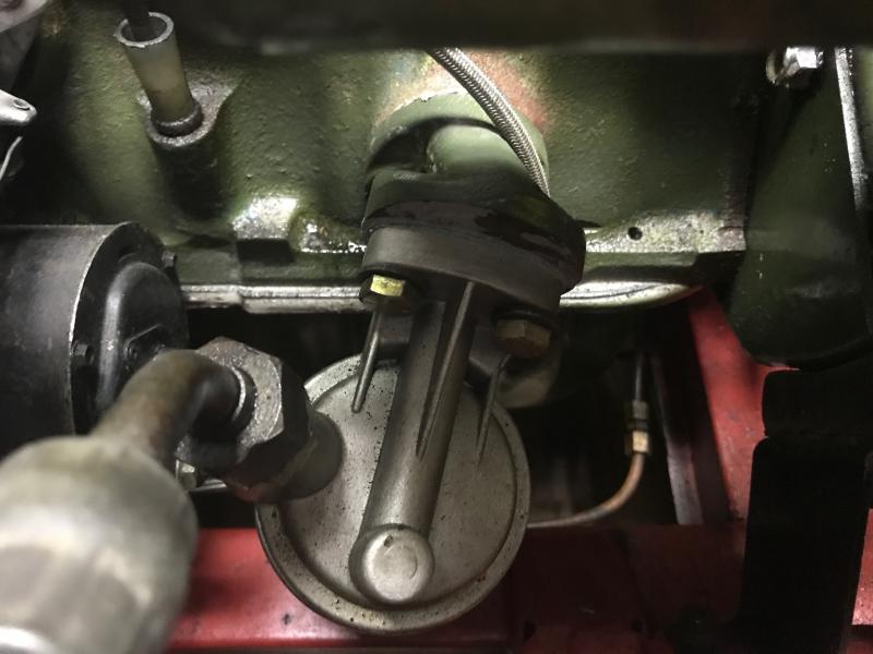

Joe, are those pictures of adapters that have been modified per specific needs?
Are spacer blocks available if needed?
The adapters are from various A series engines. I cannot remember what was from what but they are the same adapter that is used with a regular bolt on filter.
Whatever adapter/spacer (or none) you are using for your bolt on the spin on adapter should justjust stay in place. Just replace the main bolt on filter housing with the spin on.
