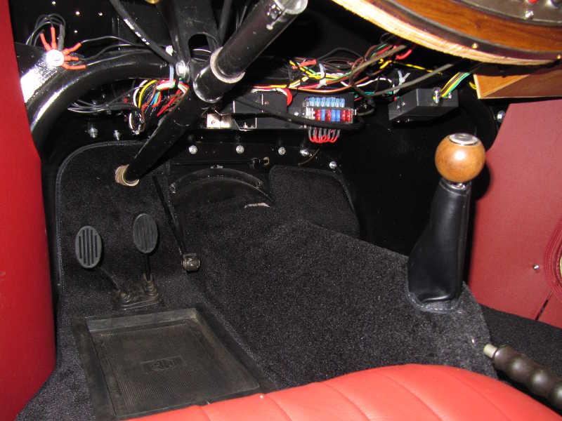

This should be a big improvement over the standard electrical system. I like your idea of tagging the wires and covering them with clear shrink-wrap. I wish I'd thought of that.
I did something very similar with my MG TD. I put the relays in a box under the dash, with the fuses on the outside for easy access. I used connectors on the wiring to the box, so it can be removed easily if necessary.
https://www.nonlintec.com/mgtd/electrics/#wiring

Steve, Some of my ideas came from reading what you did with your Bugeye, but I wanted it more centralized like I have now seen that you did on your TD. Coincidentally, a couple days ago I was looking for some heavy duty multi-pin connectors to make the dash easily removable. I found the same Cinch Jones that you used. They are good for 10 amps which should be fine for everything that goes through the dash. I also think that those connectors have been around for a while and might be considered "period correct"
