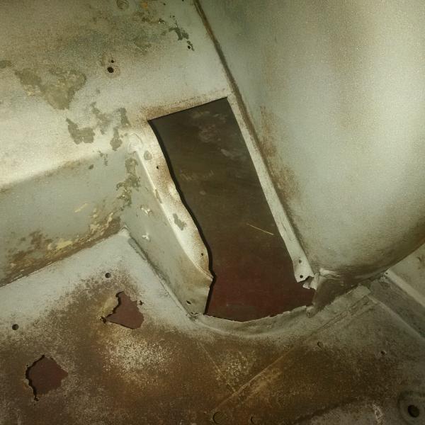

I have matching holes cut in the rear floor of my '56 - seems odd to me as they are matching and not is a spot of typical rust.. maybe they tried to add rear bench supports? Anyway, that's a curiosity.
My question is regarding the favorite way to deal with broken bolts in captive/caged nuts. One of the POs in their separating of the various panels broke the majority of the bolts for the body panels (85% of them). I could spend hour drilling and tapping, but I am not going for concourse and really don't want to spend the limited time I have for this doing that... I could weld new nuts on, but I wonder if I need that bit of movement for lining up panels.. I am leaning toward trying to drill the overlapping metal, replacing the bolt and then spot welding it back... experiences?

...The holes look like access to mount a roll bar/cage through to the frame.

Thanks John re the holes in the floor, didn't think of that - after looking at Terry's car, I've been contemplating roll cages - maybe I'll patch there last...
