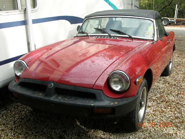

Back again, I haven't tried the Master Cylinder yet. If that fixes it I'll be surprised. At this point I think I'll try the MC and then if that doesn't work sell the vehicle. I have a pic but its too big to fit so back to the drawing board on that one.
Jim
