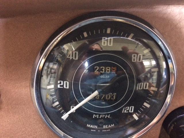

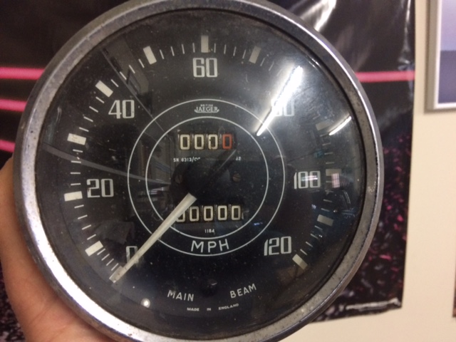

TR2/3/3A Which speedo is correct for a 1956 TR3?
jfarris
MPH between the rings?
MPH under the rings?

The original speedometer in my 54 TR2 has the MPH below the two rings. Also British Jaeger is written just above the center so my vote is also on the lower version. Speaking of speedometers, they should be mounted to the left of the tach up to TS29098 per TRA'a concours guide.

I just got back from the TRA national event. While there, I saw 2 variations of speedos with MPH or M.P.H. under the rings on TR2s and 3s. Is there any significance or timing for those two variations?
CJD
If you are talking TR2/TR3/TR3A...then the only correct one is MPH below the rings. If you are talking TR4, the inside the rings is correct. The TR3B’s I’ve seen also have below, but I would not doubt there may have been some later in the “B”, since it tended to get many TR4 parts.
Then...the early under ring speedos had periods after each letter, i.e. M.P.H.
By the late TR3 the periods were gone.
Then, there are the PN under the needles. There were several of these, and the gear range is also printed on the face, which changed based on gearing.
Finally, there were “KPH” versions...presumably with the same gearing differences.
Did you see anything beyond these? I’m always interested in variations...
TR3driver
Great Pumpkin - R.I.P
Oops, sorry, wrong question answered. I believe there was at least an approximate change point between "M.P.H." and "MPH"; but it's not well documented.
As John implies, there were something like a dozen slightly different speedometer heads fitted to the TR2-3B range. Some had different Stanpart numbers, some did not.
PS, there is a note in TSOA newsletter, Sept 59 issue, that corrected speedos (for the smaller Michelin radial tyres) were introduced at TS26656/TS26704. That might be when "M.P.H." was changed to "MPH"
