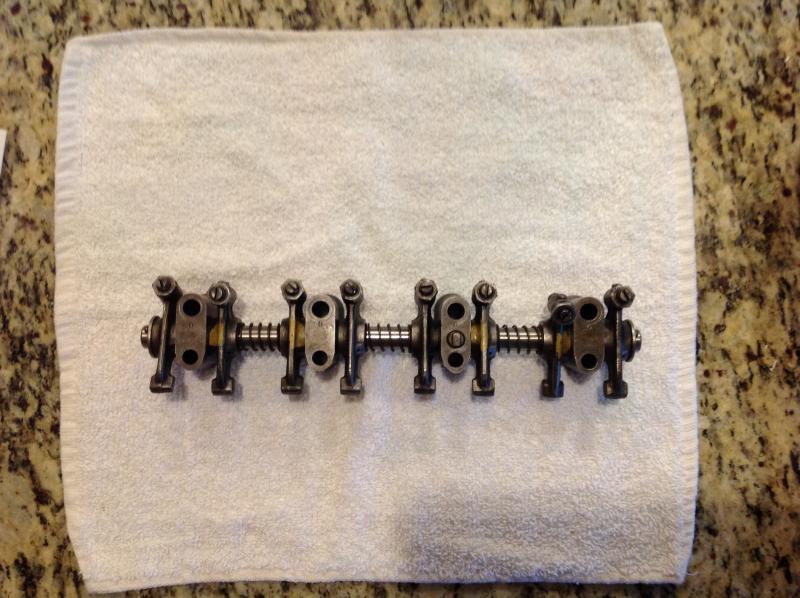

I'm in the process of rebuilding my 1275 and I have 3 or 4 rocker assemblies, possibly one from a 948. All look identical except for 1: pressed rocker arms vs forged rocker arms and 2: pedestals on one assembly have oil holes in each one vs oil hole in one pedestal. I have a new shaft and will be using the best components to make one good assembly, should I use all forged or pressed arms and should I just use the pedestal that matches the head?
Thanks, Rut
Use all of one type arm or the other (stamped steel or forged). Some 1275 stamped arms (like those used on the Austin America) had oval pads instead of round ones. The forged arms are preferred in general with the oval pad stamped arms after those.
Pay attention to the pads on the arms. Minor witness marks on the pads are OK while deep wear pockets dictate replacement.
For the pedestals, pay attention to where the oil feed hole is in the head relative to the feed hole in the rocker shaft. This changed at least once during A-series production. I remember the work around requires drilling a feed hole in one of the pedestals and giving that hole a large chamfer to line up with the supply hole in the head. Sorry... I don't remember the specifics.

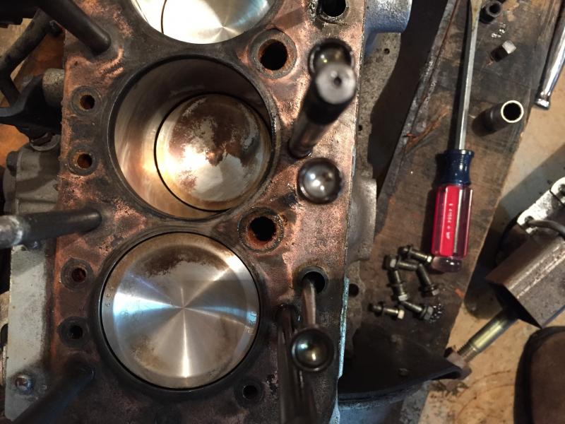

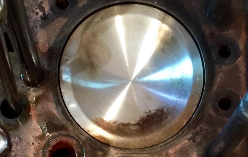

Thanks for the input! The forged rocker arms are in good shape with no wear on the valve side and fit the new rocker shaft exceptionally well. I'll make sure the oil hole lines up and double check alignment with the valve stems. I do have a couple of buggered up adjusting nuts to replace, but all looks good. I was also very happy to see that the engine actually had a rebuilt head and new pistons!
Thanks, Rut

... and double check alignment with the valve stems.
It is OK if the rocker tip is not directly over the valve stem. If you do decide to shim the arms to position them better, make sure you look at how this affects where the pushrods pass through the head. It's not uncommon to shim the arm position only to find that centering the rocker over the valve results in the pushrod rubbing the head at some point through its travel.
Doug,
Thanks great and much needed advice! My game plan is to trial fit the rocker to make sure it's where it's susposed to be prior to torquing the head.
Thanks, Rut
