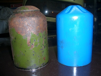

To answer you question, for engines 9C/U/H. The one on the left was for the (Tecalemet) filter; part number of the one on the left is 17H-944. The one on the right is for a (Purolator) filter part number 17H-1169.
If you have a 9CG/DA/H engine the one on the left is for the (Tecalemit) filter part number 37H-436. And the one on the right is for the (Purolator) part number 17 H-1169.
If you have a 10CG engine the one the left is for the (Tecalemet) Part number 37H-436. The one on the right is for (Purolator) part number 17H-1169.
To make things simple convert your engine over to the 1275 filter adapter and use the spin on and not worry about the hassle of trying to get the correct filter.
