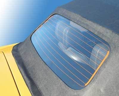

I don't mean to hijack my own thread, but PAUL161 can you post a photo of your top? I have a canvas top on my B since 1994 which is when I got the paint job done. I purchased it from MGOC in England and it never fit right. The material feels very nice and all, but it's impossible to make it snap in if the top is down and the rain comes and you just want to put the top up quickly.
Also, does yours have the headliner and come w/the window?
I'm looking to somehow have the local upholstery shop do some mods to mine so it'll function properly.

Here's a photo of my top. It doesn't have a liner but the fabric is much thicker than most and does quiet a lot of road noise. I don't have a close up of it, but maybe you can get an idea how it looks. I had the same problem with my top being very hard to snap around the rear windows and come to the conclusion that they used cheap after market snaps that weren't made by "Lift A Dot". I replaced my snaps with the original "Lift A Dots" which are better made from Moss and the problem went away. I used a two foot claw type finger grab to pull out the old snaps one at a time and reversed the procedure to install the new snaps. It was easy. Incidentally, I gave serious consideration to buying a top like yours, but without ever seeing one in the real, I decided against it. They do look nice though!

The glass one is NOT my top. Prestige is <span style="font-style: italic">now</span> making these with the glass. I got my top 14 years ago. Yours looks very nice, clean and ...well brand new!
As soon as my battery is in the car I'll be going to Chatsworth to see if they can do something about this top issue.

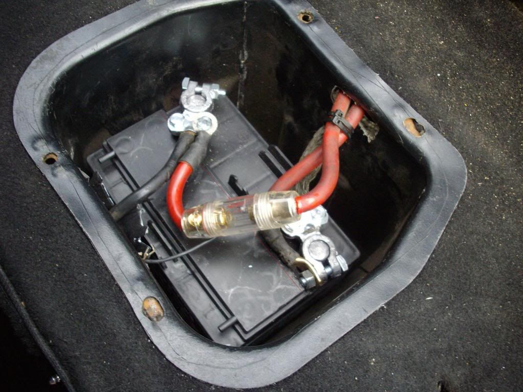

Update,
I got the Westco and it was heck trying to put it in with all the additional cables for my amp and the tiny one from the fuel pump. I didn’t have the right tools to begin with and didn’t want to bother Steve.
My across the street neighbor brought over a nice big jack and we lifted the car so we could push the battery box up, from underneath. We had to because, the Interstate was so stuck in there that even when we had the box out of the car it still didn’t want to come out.
The Westco is so small it made me laugh. After, my neighbor with the jack left I was NOT able to install it properly because of that freaking indentation on the battery that’s being outlined in red. I wish I could shave it off. Also, I butchered the battery box because I needed the hole, where the positive comes through, to be bigger and didn't have the right tools.
The positive is nice and tight but not all the way down, while the ground is not tight, and you could probably wiggle it off. I got it started and drove it. It seems to be fine.
Question: Is it hazardous to have the ground somewhat loose?
