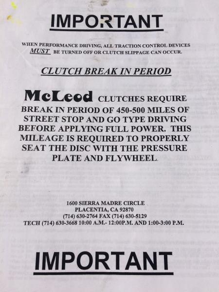

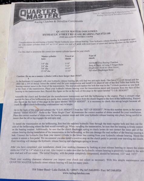

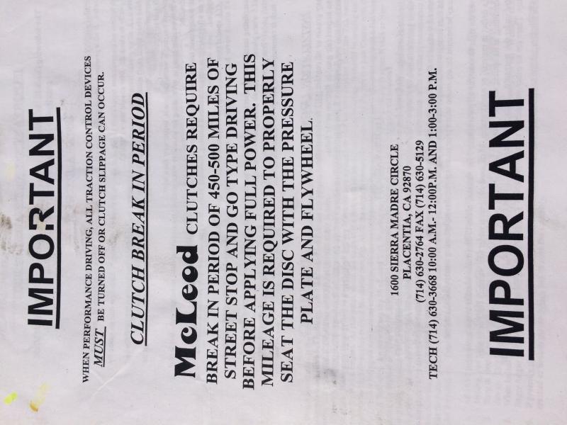

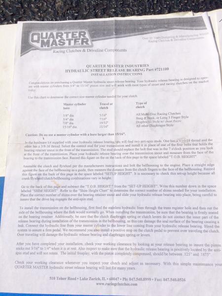

I found these two pages in my HDVA install booklet.This was for my TR6. Hope this helps.....

Elliot,
This is probably what I need thanks for taking the time to find it and post it.
