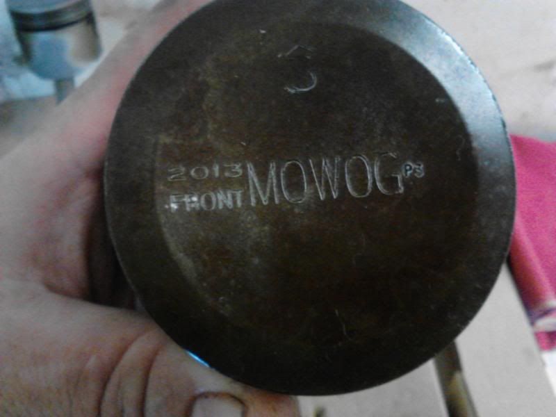

Made an interesting discovery yesterday. While cleaning my pistons I discoverd an interesting stamping on the top.. Can someone tell me what everthing stands for? I find the 2013 ironic.

The 3 with the arrow on top is the factory piston oversize. Early A series engines had factory sizes from 1 to 4. 1 being standard and 4 being the largest oversize. Rare to find a 4. Usually blocks were all oversized the same on each cylinder, but have found them mixed as well. A recent 1098 block showed two cylinders with a 2 oversize and two cylinders with a 3 oversize.
"2013" is the piston part number. The last digit corresponds to the oversize. Hence the 2013 matches with the "3" oversize.
The "Front" corresponds to which orientation the piston must be placed on the rod. Could be because of an offset in the piston pin location in the piston or because of a split in the piston skirt for noise. Other types of engines use the "front" orientation because of valve reliefs, dish locations or other piston to head situations.
"P3" is likely some kind of manufacturing date or location code. Maybe both.
There is probably some markings on the inside of the piston as well. Alloy types or other part number information. Maybe a symbol for the actual manufacturer such as Hepolite, AE, Nural or such.

Actually, the factory oversizes are closer to thousandths rather than 10's of thousandths. A 2 would be for a bore that ended up about two thousandths over the upper limit on bore size.
I'll check tonight and see if some of the literature I have at home shows the ranges. I think Bentley mentions the oversizes on one of the pages of engine specs.
C = pi x D. So, a 0.001 increase in bore diameter increases ring gap by 0.0031" A couple of thousandth's over on the bore and the ring gap gets too big and the piston noise in the bore starts going up due to the increase in bore clearance.
1275 pistons went up to a 3 oversize before they dry-sleeved the bores. One see's quite a few sleeved 1275 blocks. Good for 1380's, but not good for a +40 race engine.

Chris's engine then is still on the factory fitted piston's??

Yes, Chris' engine looks to be still on the factory fitted pistons. Albeit the #3 oversize. The other cylinders may or may not be a #3 oversize. STD rings should fit. Clearance might be a bit on the wide side, but depending upon ring set used, they may have some oversize/wear compensation included. Often, a rebuild ring set has about 0.005" of extra diameter.
Looked last night in two locations and nothing of any detail on factory STD piston oversizes. They mentioned the usual +10 to +40 oversizes, but not the stuff for block boring "oops".
FWIW, Late 1275s dropped the last factory oversize and change to a letter code. Only A and B factory oversizes show up. Have never seen a "C" sized piston in the later black painted engines.
