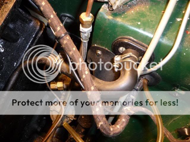

Looks like mine is not correct but here is where it comes out....through the grommet with the harness.

M. Pied Lourd

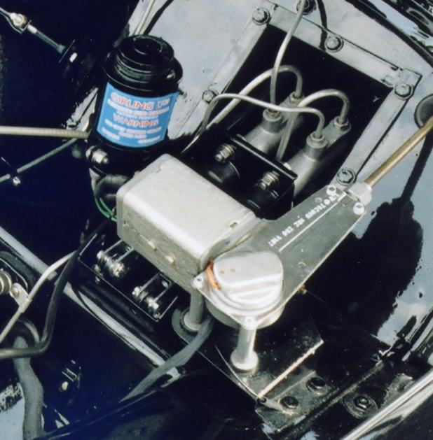

The black rubber hose from my Trafalgar bottle to the plunger pump on the dashboard goes through a 5/16" diameter (I think) hole in the 4" by 4" square plate that fits to the scuttle in back of the clutch and brake master cylinder assembly. This plate can be removed by taking out 4 pan-head screws accessible up under the dash behind the tachometer and/or the speedometer. I seem to remember that there is a grommet in the hole to pretech the hose.
You can see the black hose going up and then under the reservoir for the brake/clutch fluid then it goes to that small access plate described above.

Thanks all of you for your input. Special thanks to MP and Don for their pictures.

Thanks Viv, a mystery solved. I did fill mine with a small blanking plug.
