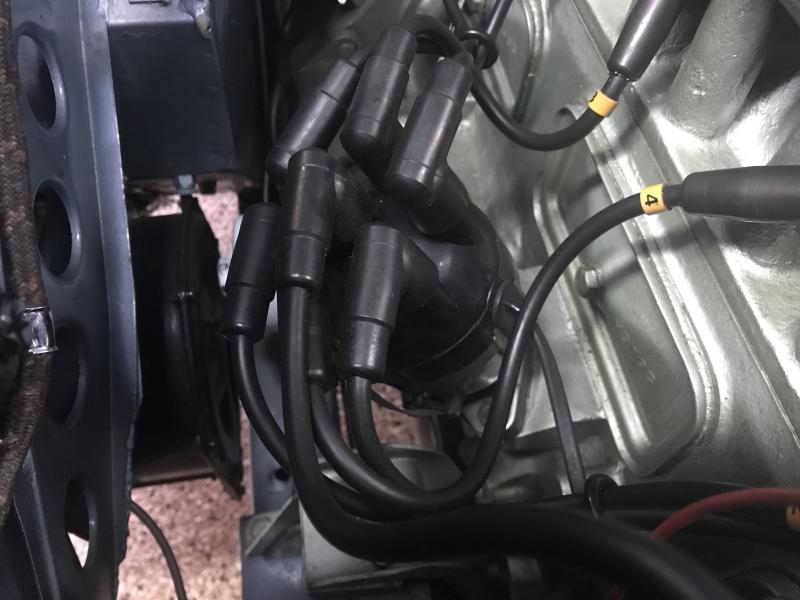

Lucas side mounted distributor cap has been replaced with a top mounted style.
Wires are 7mm Carbon Impregnated fiberglass core (copper wire was interring with the electronic tach)
