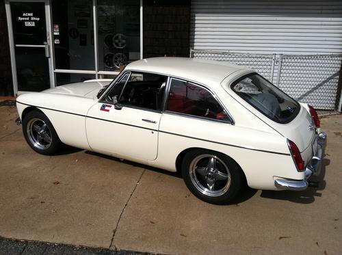

I put probably 200 MGBs on 15x6 +24mm wheels, most use 195/60/15 tires, here's one of many, this is the VTO 15x6 Lemans on 195/60/15 General Altimax HP tires.
