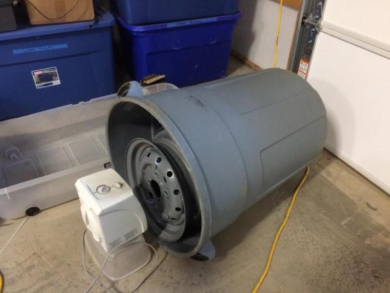

My mobile heat treating booth. Using the portable heater really did bake on the finish. I put up cardboard to help keep the heat focused.

Thanks to all for your input. Probably won't be baking them in the new oven. My bride of 40 years has never really bought into the mentality of the self flagellation involving little British cars. Callaway- How long did you heat each wheel in your garbage can device? Valspar canned paint laid out well and seemingly bonded to the original. David. I do anything I can to avoid using today's paint removers. Back in the day they really worked but govt. regs knocked the punch out of stuff you can buy today. I feel your pain in bench stripping wheels. A dip tank might work if they soak long enough but the cost of that much product would be painful. Thanks, guys.
