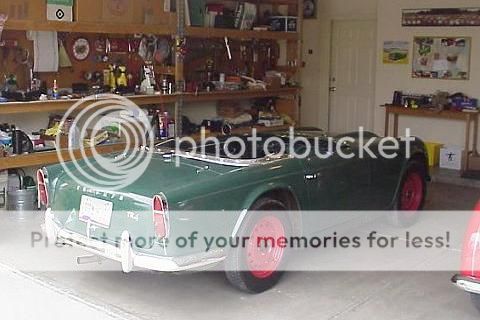

Of course, if original is not important -- then anything goes:
I had a real good reason for doing that. Festive too.
