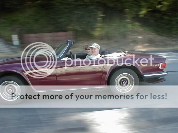

The PO of my car painted the rims what he said was "gunmetal gray". I don't know if that was a standard color or not. Looks unique to me based on what else I've seen. I don't know how it would compare to "smoke" gray.
