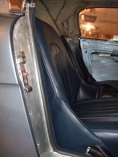

clean them up with real fine steel wool, then spray them with urethane clearcoat. These were done in the early spring and there is no deterioration of the finish and the clearcoat sticks real good.

Thanks to all so far, look like a mix of polish, a "spritzer", steel wool urethane clearcoat, and a lubricant. Any others?
I actually tried the steel wool and clear spray on one of the old pieces and while the steel wool (fine 0000) cleans it up nice, I found when the urethane dries, it make it actually look duller. Maybe I am using the wrong spray. I am not using the satin?
Thanks
jjs64bj8
Yes JJ, some clear coats will make the colour just alittle darker. especially if you are using a spray can clear. For the clear coat to be the brightest and to last you must use a catalysed, two part, clear urethane such as made by PPG or other automotive paint producers. If your spraying is not up to snuff you can also wet sand it with a 1500 grit paper then buff it. Just like they do when they clear coat your car. In my case I was very happy to just get it clean, shiny & protected because not only were mine, cut up, bent up, and torn but when I bought the car they were painted black of all things. I think they came out pretty good considering. I might suggest that you use some kind of buffing compound for silver or brass as Randy mentioned. That might make it brighter than the fine steel wool. But you would really have to make sure you get all that compound off before you clear coat it because it might affect adhesion. I really don't know. i believed the steel wool finish would help the adhesion.
Yes thats the correct Gibbs.. if you have new shutface panels use the Gibbs, I would not try and scuff for clearcoat or clearcoat at all . The originals were a satin aluminum base and the raised dots were polished. The dots are only protruding a few thou of an in. and you will never be able to scuff or polish them without touching the satin lower part. The whole point is to protect the alum surface from corroding to a duller grey as they did from 50 plus years of driving in all kinds of climates.I would just use a protectant and clean /reapply as needed.
