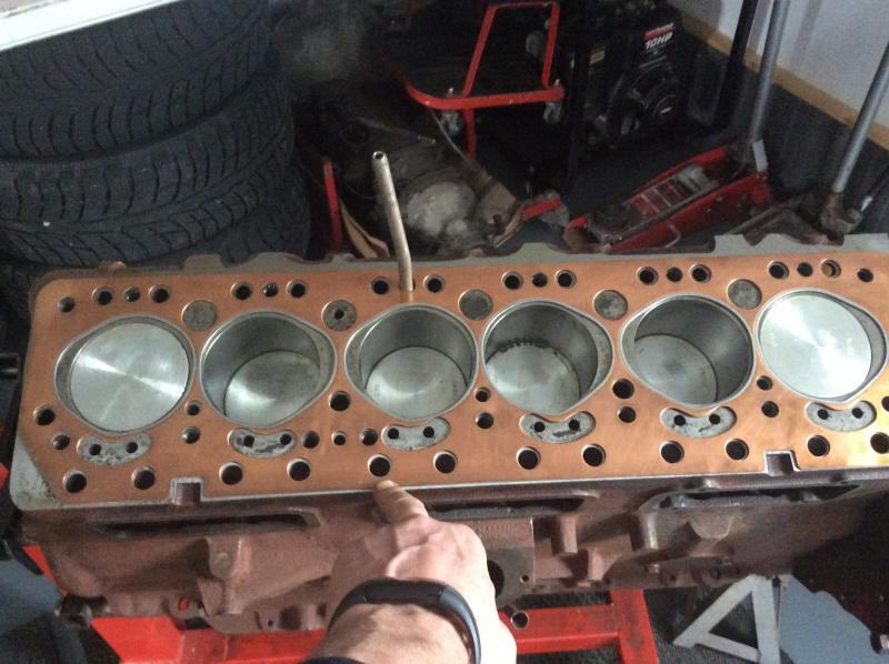

So why would they make the gasket web so narrow and that close to the firing zone of the cylinder . They could have made the gasket web wider to give more sealing area . Its not like the coolant holes need the space etc .
BT7 engine , in the process of rebuild .
Cylinder head almost ready for reassembly with new guides etc etc .

I couldn't agree with you more. I guess they weren't worried about sealing the push rod holes for oil leaks either. My head gasket has weeped oil from along that edge now for quite a while. I haven't replaced the gasket because given where the head bolts are and where the push rod holes are I don't have a lot of faith that the new gasket won't weep there as well.

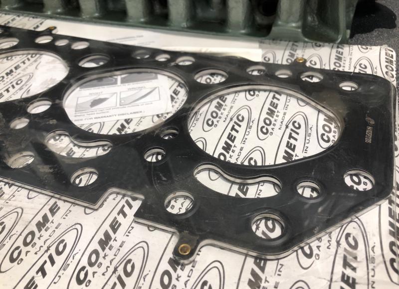

I have all my head gaskets custom made by https://www.cometic.com/search.html?q=austin+healey My race motors require a special thickness which they can can make in up to about .300. If you've shaved you head a little too much, they can help. You just need to call them direct, the web site's not going to give you the information you want.
Tks Dougie .
Im not in a bind with what I have it was just something pointed out to me by the machine shop . We were looking at the pitting that forms around the coolant passages and when I compared the gasket /block/head it becomes obvious that the pitting wont matter as there is no gasket there to seal . They could have made the webs wider and made the area of gasket coverage around the smily mouth coolant passages much better .
I havent had a head gasket failure (touchwood) but I would think that really thin web close to firing zone is the weakest link in the gasket.

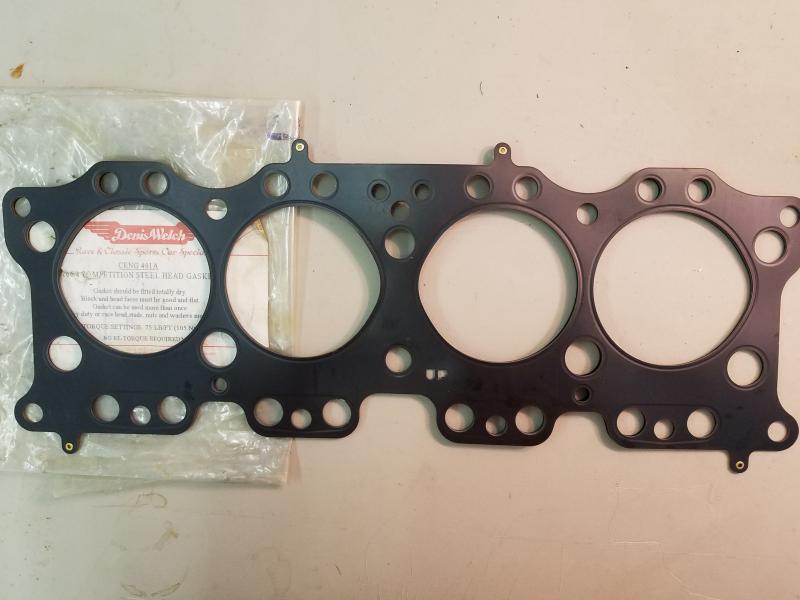

To drag us back to the thread's original topic, attached is a photo of the DW steel/composite head gasket I use with the DW aluminum "Fast Street" cylinder head. This is the spare I carry on top of the fuel tank under the floor of the boot. As you can see there is a good bit of material between the holes for the passages and cylinder bore. The original has been in place for about 60K miles without needing to be replaced or retorqued though I have lately had a teeny bit of water seepage above the number plate after shutdown as things cool and contract.
If that's the DWR gasket, I think they all but guarantee it won't leak. Norman Nock recommended coating with WellSeal, basically a type of shellac. We used it on our BN2 and a stock gasket and no leaks, but it's only been driven maybe 1,000 miles. I think the quality of the gasket sets has gone down over the years; fortunately, I had an old set from way back and we used it on the BJ8 rebuild (can't think of the name of the company, but they are big in the business; originally made in England but who knows, now?). When I was shopping parts for the BJ8 I saw Moss had a 'premium' gasket for about $300; I'd bet a fin it's a DWR.
Yes, it is the DW steel/composite gasket which is recommended to use in conjunction with the AL heads.
