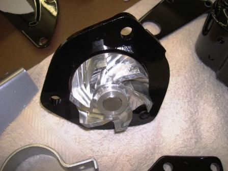

Keith: This is the one we put in the 3A. During our trials with the test rig the weather was very warm and humid. I parked the "rig" in the sun and let it idle until the small gas can ran dry, maybe 20 - 30 minutes. In addition, considering that the body was not on yet, there was no benefit of ducting through the front apron opening. The engine did not overheat. Of course I have the benefit of a fresh engine and radiator. After she's actually on the road for a while, I hope to write a report.
Frank where did you get that pump, and around how much was it? No decission on my part yet what pump to buy. Thanks
