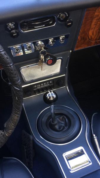

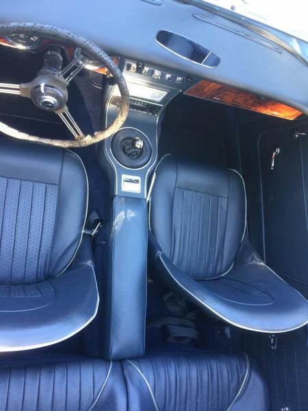

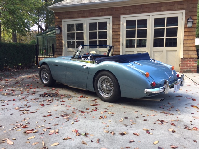

If your objective is to have a perfect show car, have it professionally restored and trailer it to preserve it. If your objective is to have a wonderful, gorgeous car to drive and enjoy, have it professionally restored and drive it! A professional restoration doesn’t mean that you must only admire it. My car is stunning to look at and drive, and I am not concerned that the underside is as perfect as the topside. I’m careful with it, but if it gets dirty, I wash it. I park it in parking lots and in the street. As it inevitably gathers the signs of use, it will mean that I have enjoyed my car. My advice is to have a professional restoration if you want to have a gorgeous, brand new car to drive and enjoy and not spend years getting it to that point.
My shop does fixed price restorations, in sharp contrast to the tales of restoration bottomless pits. The price they quoted is exactly the price I paid, and I got a perfect, show quality car, in less than a year. It needed significant welding and body work—it was a pretty typical Healey restoration. I upgraded certain things including mohair, wool, leather, chrome Hendrix wires and SS exhaust, and total cost was in the $70k’s. My shop restores cars to sell just like mine, and they sell them for over $100K. I had little into the car in the first place (my dad bought the car in 1978 for $2,000), so I am not upside down with a professional restoration.
My cost/value numbers are for my BJ8, so I can’t comment on the equation for a BN6, but I suspect that both numbers would be less. I thought I would reveal a bit about the cost of my restoration to give some perspective. If a number like that does not give you heartburn, then I can say that, at least in my experience, you will have a jaw dropping, gorgeous car that is a blast and a joy to drive!
