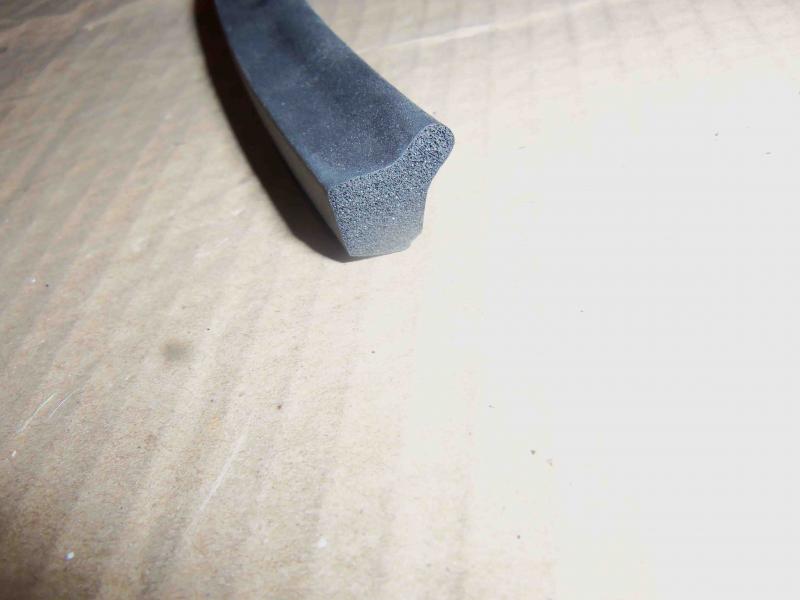

Just opened my door seal kit for the 3A and don't know what this seal is for. Figured the other out but this stumps me.

Looks like the A post seal. The fabric edge is glued to the metal and runs from the bottom of the A post all the way up to the side of the dash. If it is shorter, it is for the b post and sits behind the edge of the finishing panel.

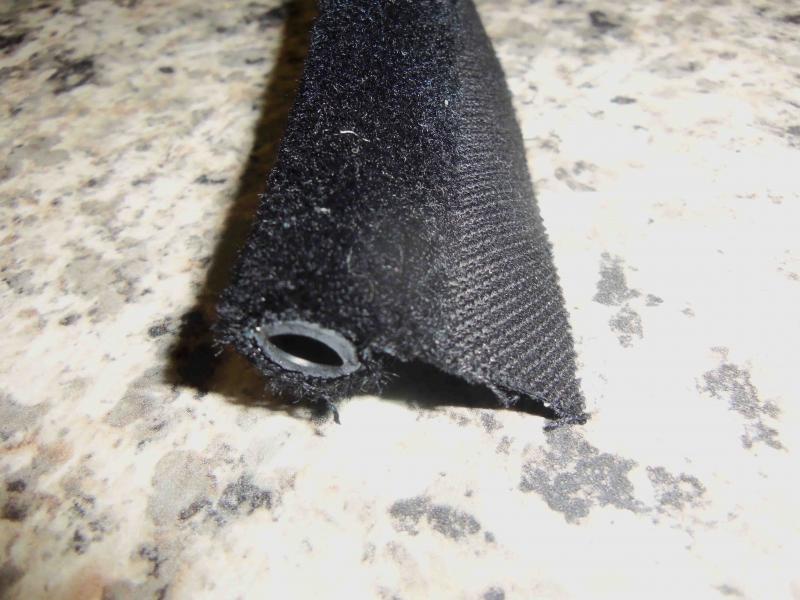

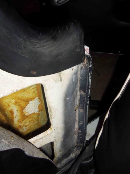

Currently on my B post there is a bead with leather around it stapled into the B post pic 1. The other pic is a seal in the kit that said back door seal. Does that get glued to the be post? Pic 2

Then the leather/vinyl piece is wrong. The cloth covered piece you pictured should be installed in its place. It should also be on the front edge of the door opening.

The kit did come from TRF. The piece that looks like the spare tire cover seal "I thought the same thing" is listed as the rear door seal. It is only 12" long. Seems to me I've seen cars that had seals glued to the B post before. That would seal the door up nicely. As far as the draught seal I had to look that one up and found it is the British spelling of draft. I didn't think it was designed to do much more than that.
Anyone have a pic of the rear draught seal? As far as the quality it seems fine. TRF's rubber parts are of better quality.
The draught seal goes where you have the leather seal stapled to your B post. Some parts diagrams show a rubber seal glued to the rear vertical edge of the door as well as having this draught seal on the body of the car.

The rubber seal is the same as came in my kit from TRF and it is glued to the back of the door and seals the door to the b piller. When you shut the door it gets smashed together to form a seal and stop door rattle.
