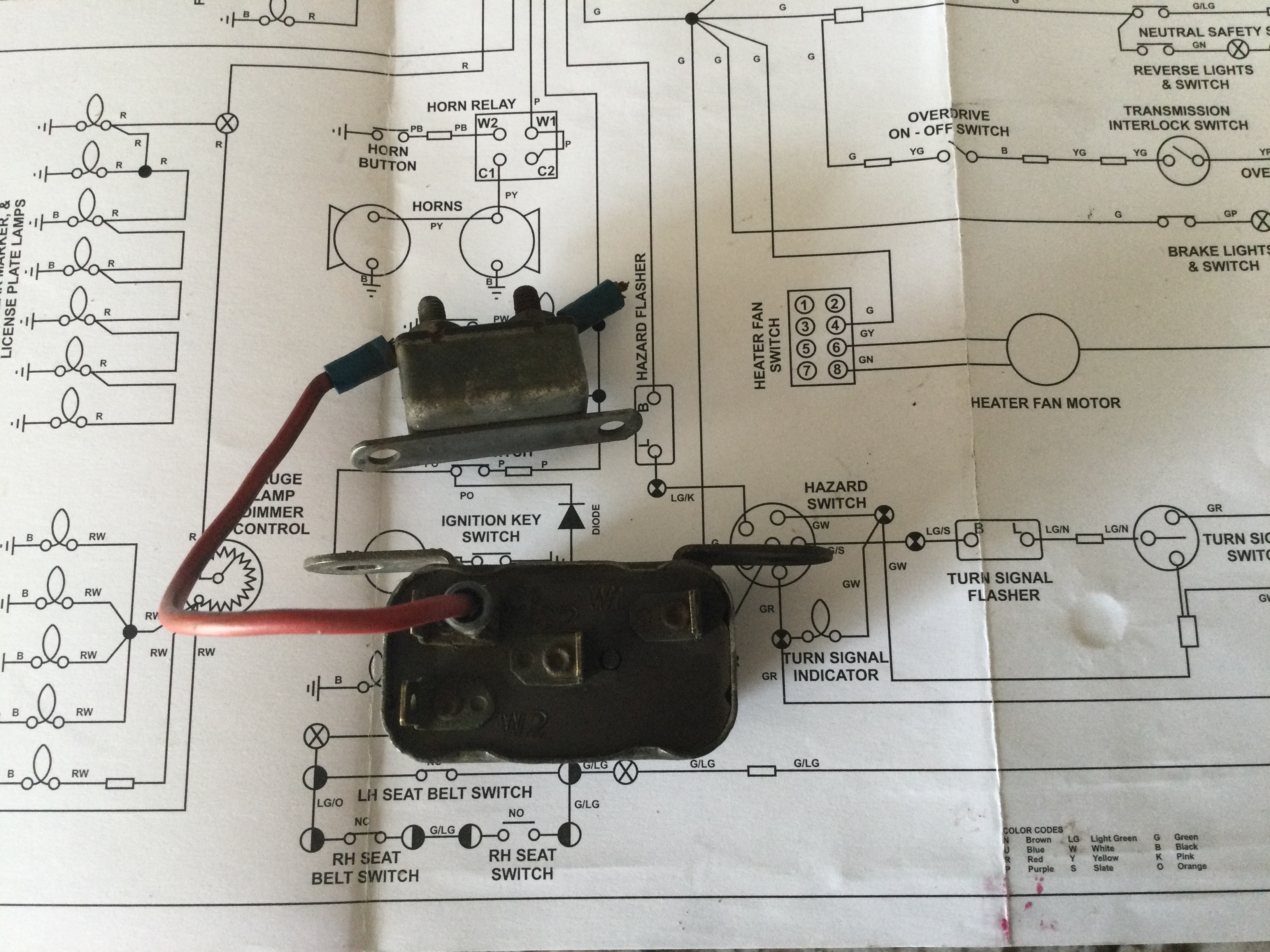

Oops, I am getting 2.3 ohms resistance through the poles after cleaning it up a little more. It is connected to C1 on the relay... is it just a fuse protecting the horns?

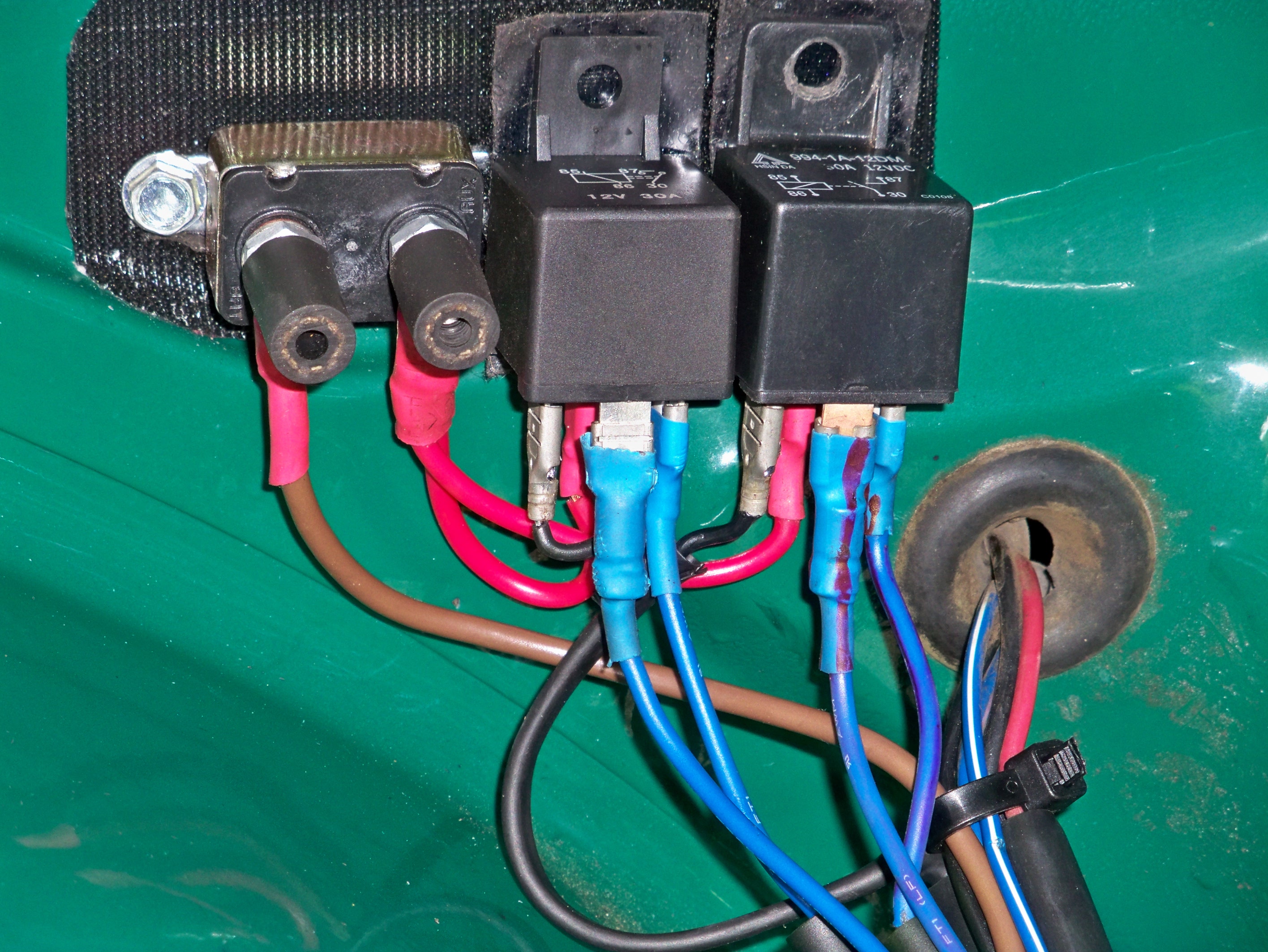

Is that the fixed mushroom cap style Velcro? Love that stuff, I am holding a few components in place with it. Big time saver in the right applications.
Thanks...no not me...the PO did that when he rewired the car, I just added the relays for the headlights a few years ago.
The Brown wire feeding the circuit breaker is getting power from the battery's terminal on the back of the alternator.
