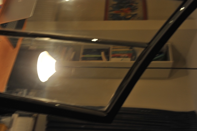

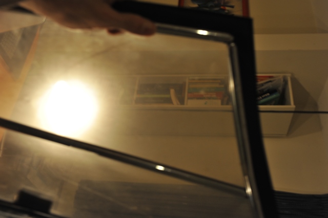

Use a cleaner (Poorboys Professional Polish) or soft polish first to remove dirt and oxidation.
Do this on both sides.
303 is good as protection, a dressing for rubber and vinyl (Poorboys NaturalLook) will keep it flexible.
Before;
After (90/100);
