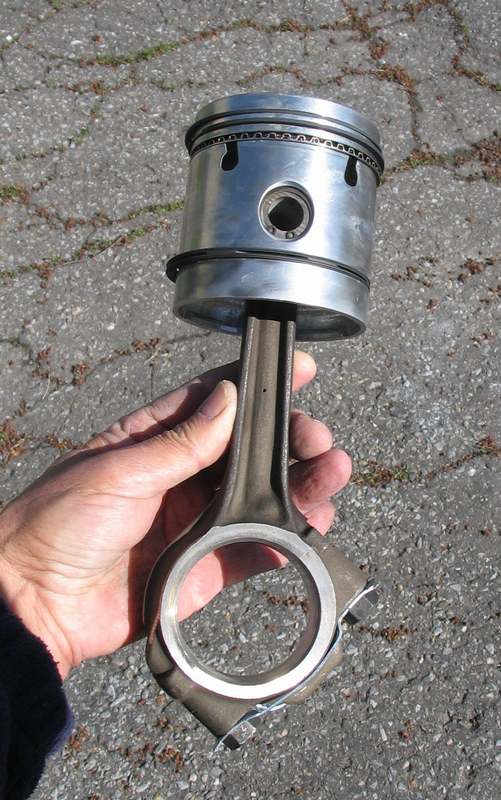

When I restored my 1958 TR3A from 1987 to 1990, I re-built the engine with new pistons, rings and liners. In 2007, after driving 94,00 miles on the "new" engine, I decided to do another re-build. All I had to do was clean it up and change the rings. Naturally at the same time, I installed new gaskets, new bearing inserts all around, etc. The 4-ring Hapolite pistons from 1990 were very clean. During those 17 summers of driving, I had used un-leaded and there was nothing to "de-coke". I'm certain that modern gasoline leaves your engine cleaner than leaded did during the first life of my engine from 1958 to 1990.
