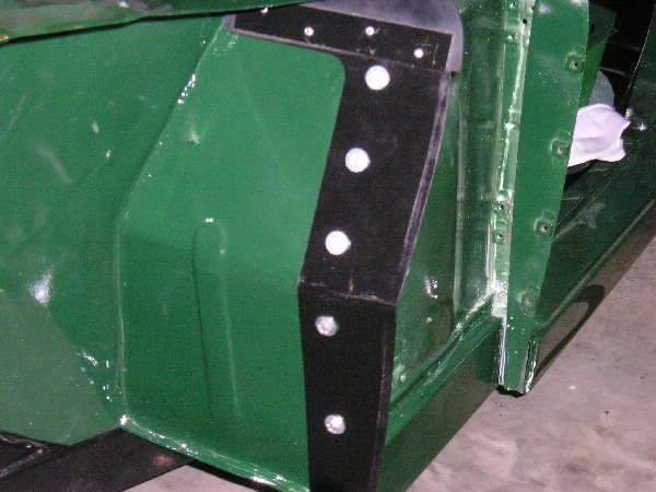

Does anyone have large format pictures handy as a reference, becuase I'm guessing it's not supposed to be like this...
I think that looks pretty darn good other than the small lower patch for a original car.

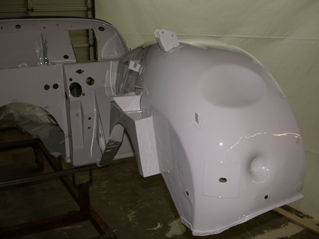

I'm not certain exactly what you need in the way of photos, but perhaps these would help. PM me if you need further detail.

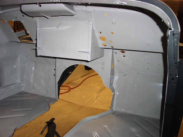

Here's what mine looks like.

Thanks guys - those pictires help.
So there looks to be a lip at the very bottom that kicks out. Does that rest on the end of the floor board? Would the correct order be replacing the floorboard then welding the bulkhead repair section in?

IIRC the lip that sticks out is both part of the bulkhead and the floorboard...double layer...
I replaced the floorboard first, and then welded in a repair section for the bulkhead.

Interesting - Randall it looks like yours does not have the same lip at the end. Did that vary based on production year/sequence?
Mine is TS34909L

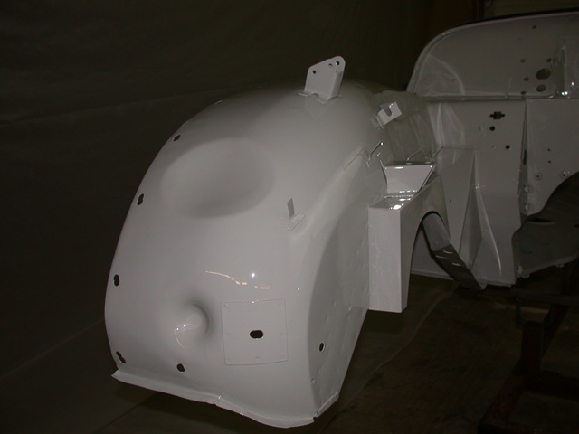

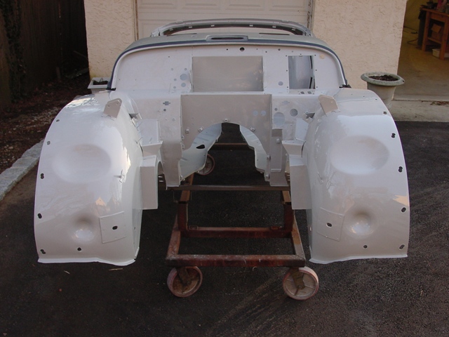

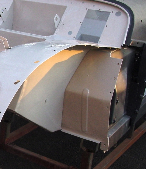

On the two pictures angelfj posted, could someone tell me what the two holes that are below the over rider attachment point are each for. I am in the process of painting and repairing my engine bay and those tow holes were not used when I took the apron off, but I suspect they should have been.
Re: What is a bulkhead supposed to look like on a
tdskip - That lip you see in other photos was only on TR3As after TS 60000 and on TR3Bs. Yours should be down that slope and the excess should form a flange backwards under the floor pan. If you're buying new floor pans, you will find them too long at the front for you early TR3A because the floor pans anre made for the later TR3As. So if you are changing your floor pans, you will find you will have to trim off the front "lip" area (about 1" across the front edge of your pans so the sloped wall of the foot-well can form a flange backwards under the floor.
The 'floor' of the grille opening should have bolts that go into those holes.

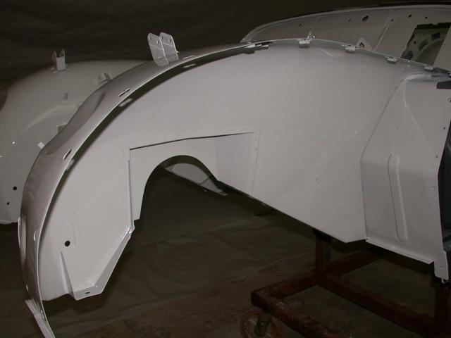

Here's a shot by 'rlandrum' where you can see the tabs that take those bolts.
Thanks Randall. My apron only has one of those tabs with the hole in it (the left most one in that picture. I guess I will weld some on before I reassemble since e I will be painting the inside. Are there captive nuts behind the inner fender or is it a straight nut and bolt?

Thanks guys - this is a big help. Having the bulkhead flange backwards and meet up with the bottom of the floor board (if I'm understanding you correctly Don) will make this a pretty straight forward repair I think.
No captive nuts AFAIK. Looking at the parts manual, it appears that some cars had clip nuts and ACME threaded screws, while others just had bolts & nuts. Mine have only had bolts & nuts, but I was certainly not the first to remove the apron so that doesn't prove much. I assume the clip nuts would have gone on the apron panel, but again I don't know.
