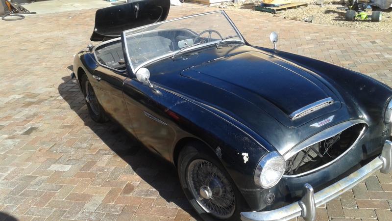

I'm importing a big Healey from LA due to arrive in the UK mid September.
I'm not sure which one I've bought. Its a 1959, 2+2, drum brakes on the front and twin carbs.
The title is with the shippers but I am told the vin number is 6716859.
I'm assuming its a BN4 with a six cylinder 2.6 engine but I'm not sure..!!
Any ideas ?

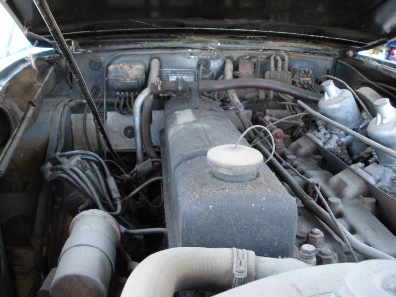

20160724_082441.jpgnine.jpgIts a restoration project. Been laid-up in Arizona for past 40 years with 28000 miles on the clock...

From the pics you can see it has the later 6 port head with HS6 carbs so a little more power, and likely the OD transmission, as you can see the OD relay and throttle switch to the left of the fuse box. Gotta love Arizona cars, probably has little rust. Nice !
Yes has o/drive...Seller says..the only rust is a small patch under the fuel tank.. but will have to wait & see..!
I'd be shocked if that were true; even my California car had a bit of rust in the doglegs.
Mine also had the forward/LH outrigger rusted through, no doubt as a result of leaking corrosive exhaust gasses, but at your car's low mileage, let's hope you side-stepped that ailment!
