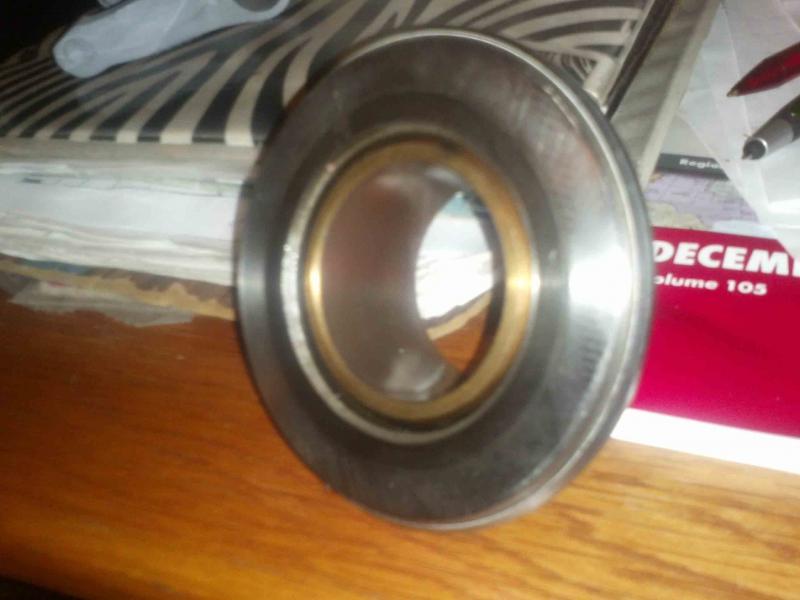

Did a search and a lot of discussion on throw out bearings. The bearing I currently have doesn't have a lot of miles on it may be 10 to 12K, however I was taught that you always change the bearing when you have the tranny out. When I was cleaning the shaft and related parts the bearing fell into the parts washer and was submerged for a while. When I pulled it out you can see all the lubricant running out of the seams. So don't know if it's any good now.
Starting a search and open to discussions to see who has the best bearing. Just rebuilt a TR6 A-type tranny and my goal is to put it in the TR3 and drive the car for the next 25 years and not have to take the tranny out again.

Yeah, for sure it's no good (IMO) after it's been dunked in solvent. They are factory loaded with a fairly special grease.
I was taught the same as you, change it every time. But I don't, because so many replacement parts are defective that I would rather install a "known good" part than a new, potentially defective one. In all the decades I've been reusing throw-out bearings, it has only bitten me one time, and it turned out that time I accidentally installed the wrong one! (Found my "known good" one still sitting on the bench.)
I can't say if the TRF bearing is really worth the extra cost or not; but I know that they try hard to bring the best parts available. Usually when there is a big difference in price, it's because one of them is selling no-name bearings from India or China while the other is selling brand name (ie RHP, Timken or National) bearings made in the US or UK. To me, an extra $40 vs having to pull the gearbox again (and taking a chance of it failing away from home) is a no-brainer. But there was a time when my wallet was thinner and my back was stronger when I might have gone the other way.

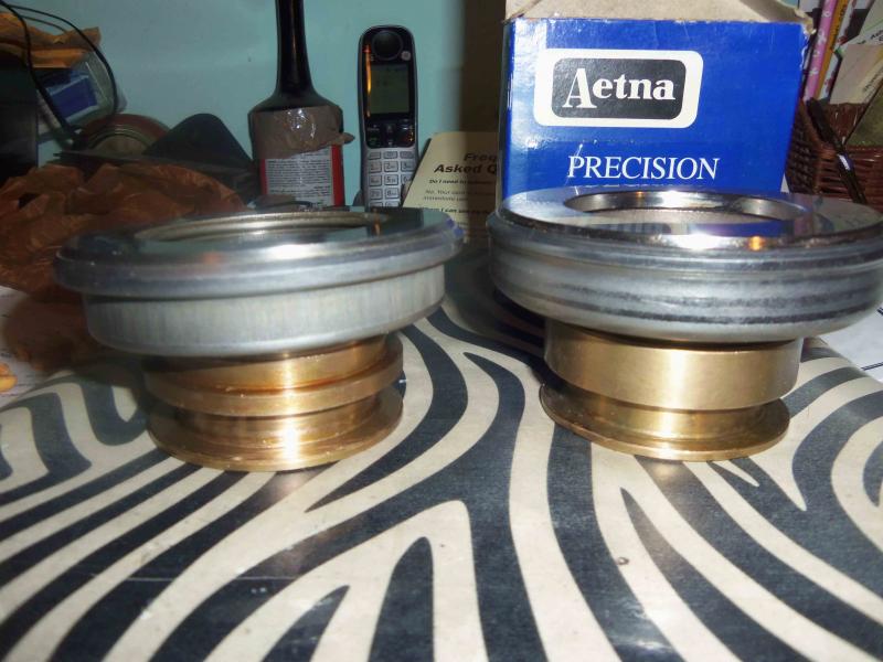

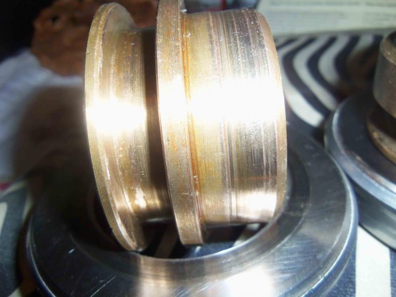

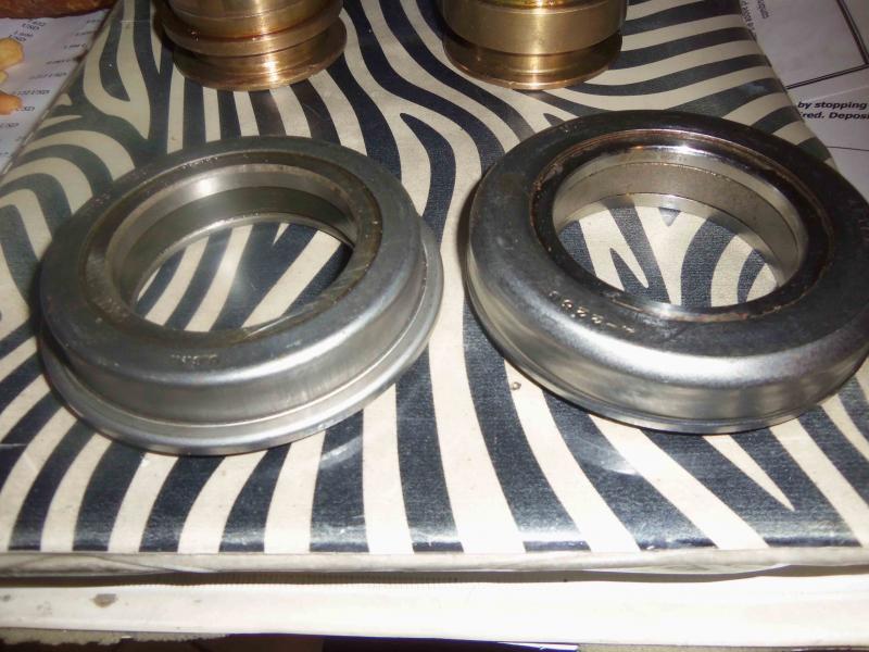

I wasn't planning to heat the bearing up much but what I just discovered I'm sure your right I won't need to do it. I just pressed off the old bearing and was going to press on the new Aetna bearing when it came off with little pressure. Take a look at the bushing and near the center collar where the bearing rests there is less then a 1/4" ring that was holding the bearing on. In front of that ring are wear rings where it looks like the bearing was slipping on the bushing and there is a noticeable difference in the diameter of the bushing. The new bearing drops right over the bushing where the wear marks are and only wants to grab the 1/4' ring. I'd say not enough surface area to grab the bearing. The other bushing in the pic is from a TR4 tranny and I'm going to have to turn it down in my lathe to match the TR3 one.
The Aetna bearings are much more substantial in size and weight and I did get it from my Moss distributor for only $20. good value there.
