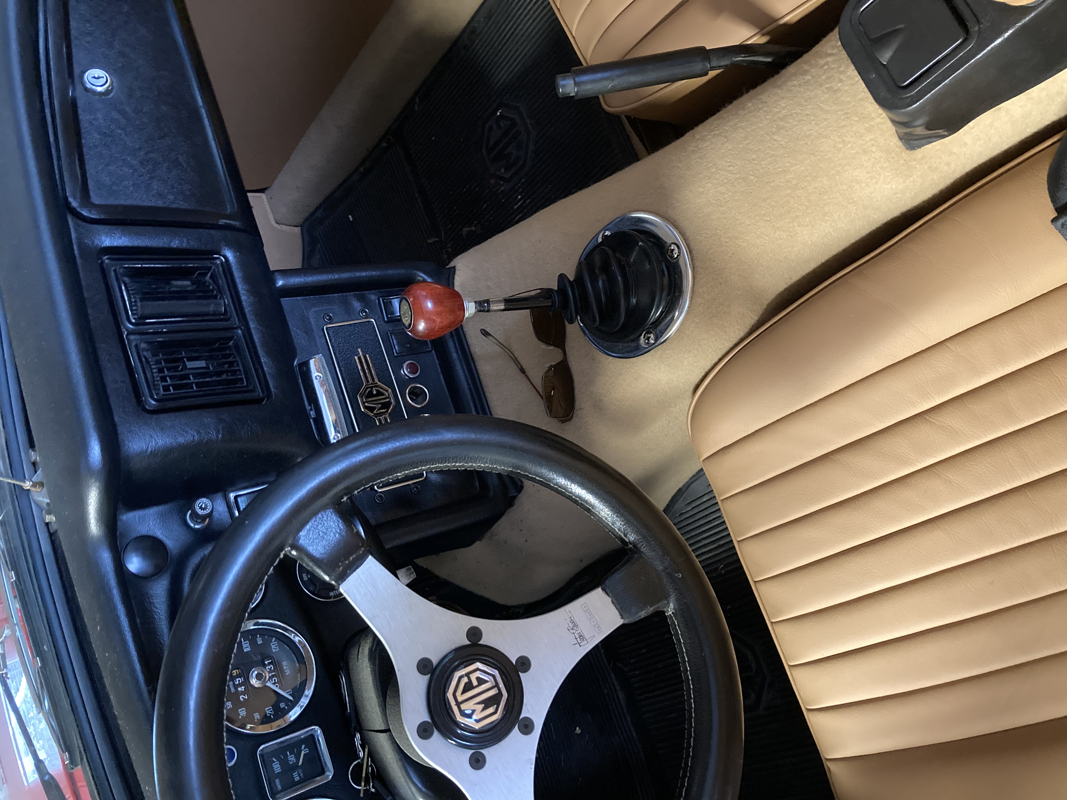

I decided to redo my 1975 radio and center consoles. The large plastic radio console in my opinion looks terrible but the late 60’s early 70’s have a better look..IMHO..so, I found a radio console, cleaned it up and put it in. I cut the original center portion out from around the gear shift and re contoured the back section where the armrest is. It’s not perfect but it gives me an armrest and a good looking radio console, while giving the ‘75 a more classic, older look.

I think it looks fabulous, but me thinks you posted this in the wrong forum. You posted it in the forum for new members to introduce yourself. But not to worry, I am the all powerful Basil, aka Boss, and can magically move your thread to the correct (MG) forum and give your topic the correct (MGB) prefix. If you are reading this, you are now in the MG forum. I'll leave a "pointer" in the original forum that will expire in one week.

Well done, looks really nice

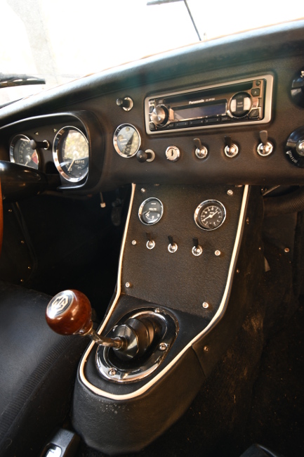

Looks appropriate for the car. Ours is a '64, so steel dash. I did a replacement for the monaural speaker in the center with additional instruments and switches for cooling fan override, horn switch-over between standard and air horns and under-dash courtesy lighting. Attempted to keep it "period correct".

Did you make your own console?
Yes. Aluminum sheet laminated to 1/8" plywood, countersunk switch holes. Instruments are from Nisonger, a voltmeter and clock. The bolsters are aluminum with laminated closed-cell foam and covered with vinyl matching original material (sourced from Moss). Switch panel wrinkle painted to match dash.
I want to wrinkle paint my console, what did you use?
"Plasti-Kote" brand and Florida sun. Follow the directions exactly or you will find yourself sanding it all down and doing it over... a lesson learned long ago.

I used VHT brand wrinkle finish paint. Advance Auto and AutoZone both carry it. Can be cured in oven, with a heat gun, or hair drier. I actually hung my painted stuff in front of the fireplace (winter time, of course...). Came out great!
