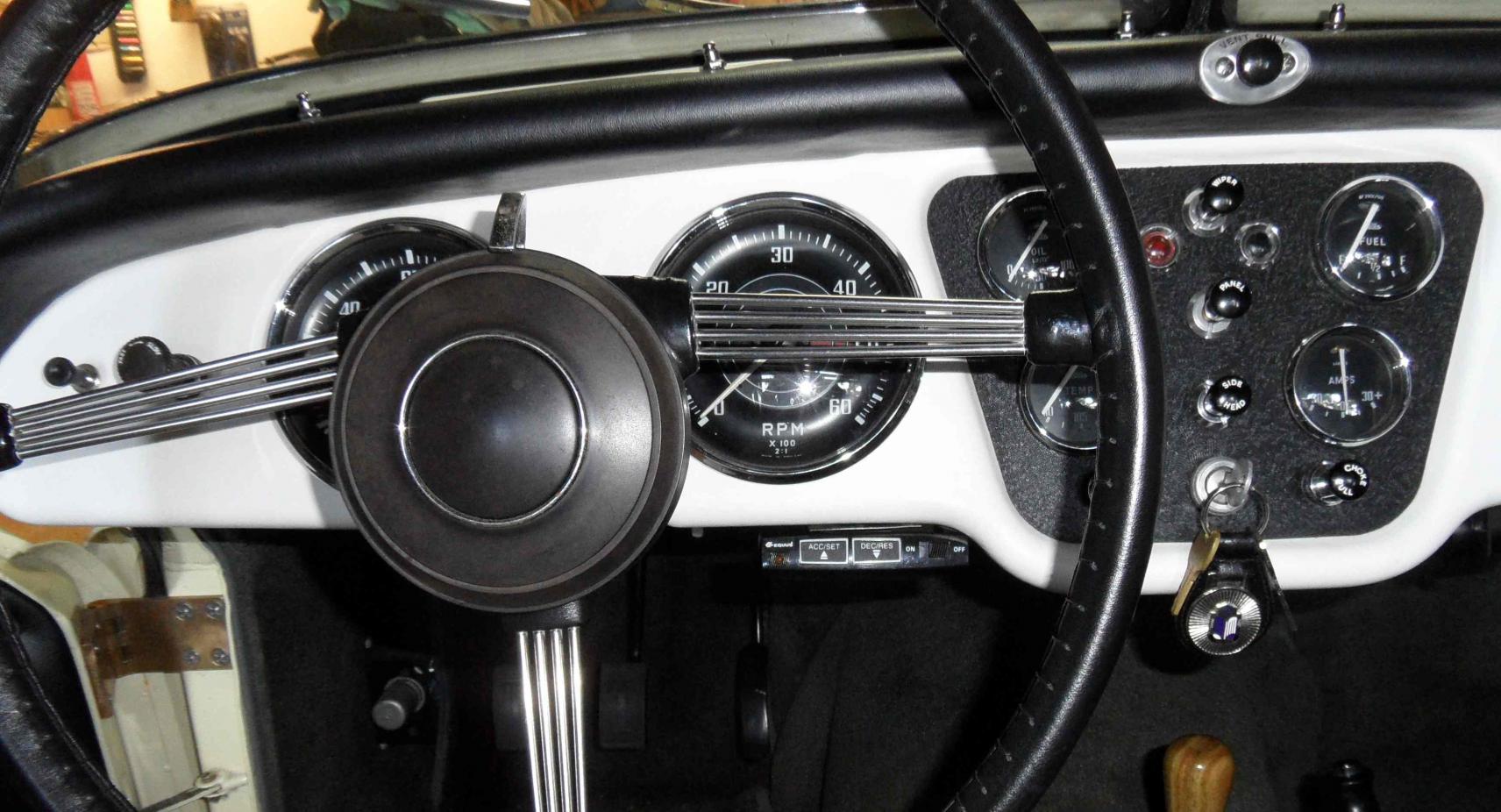

I tweaked my latest accessory. It took a little driving to get the servo 'centered'. It doesn't work quite as good as a unit on a new car, but at 75mph, unless you were to notice the indicator light, or my foot away from the pedal -you wouldn't know I was cruising.
The servo is under the apron by the right head light. The cable pulls from my center-pull linkage on my H6Ss heat shield. The TR4 intake already had a vacuum port to power the servo. The inductive pick up in the #1 spark plug is the only obvious modification under the hood.
The only thing this really enforces is the notion that we never really get finished with our car.

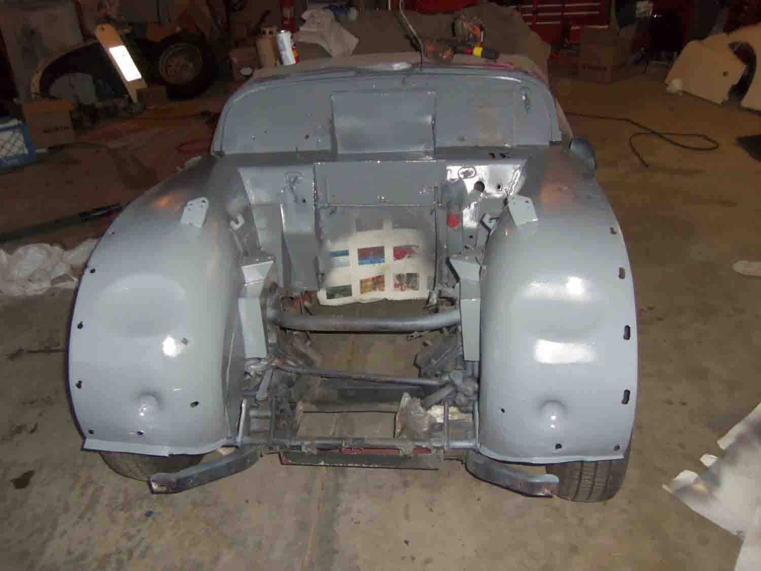

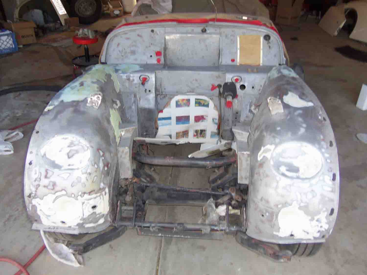

Sanded, filled, sand blasted and primed. All in one day!

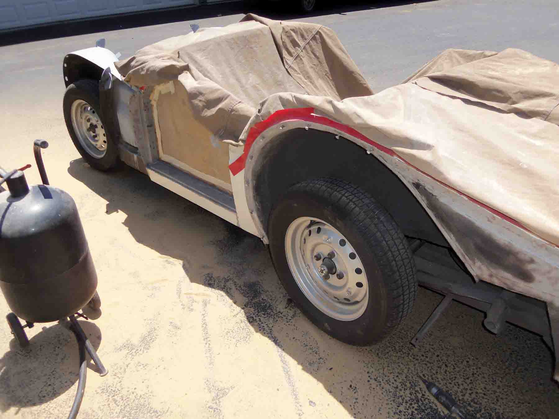

Worked 14 hours on sand blasting the rockers, door seals and rear wing edges. Rust was creeping under the paint so got rid of the old stuff and used a modern day epoxy primer with better corrosion protection.
