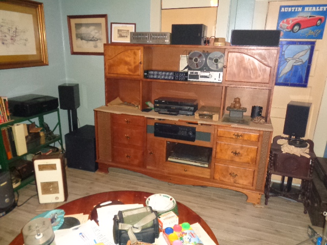

Don Williams this morning. About half way through this batch. Pic is of the unit that houses the stereo stuff. My father made it in 1958.
