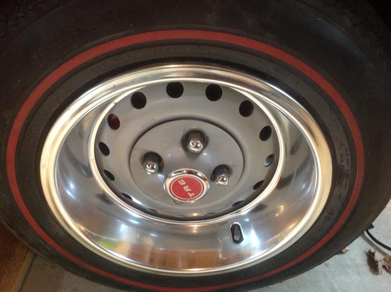

I have 4 original wheels in excellent condition with center caps, trim rings and Michelin Red Line tires with 75% tread on my 75 TR6 and an thinking about selling them and putting on a set of 16" Konigs. What do you think? Originals with Red Lines or new Konigs with performance radials?
if Konigs, what are the originals worth?

If your car looks as good as the wheels, you might want to keep them ( in case of selling or showing ) and get the Konigs for street.
Check the date on the tires, they do have a use by. As suggested, set them a side for show, if you have room.
Wayne
here's how to determine a tire's manufacture date:
https://www.tirerack.com/tires/tiretech/techpage.jsp?techid=11
if they are old - say 7 years or more - they are suitable for tire swings, not driving.
the rims may be easier to sell [and certainly cheaper to ship] w/o the tires.
ps - i'll add, those wheels look so great it seems a shame to separate them from the car. if you just feel like a change perhaps put them asde for a few years and bring them back when you tire of konigs look. I run an assortment of wheels - steel, wires & vintage alloy just to have some variety.
Those look like the original brushed aluminum trim rings. If they don't have any curb rash on them they would be worth as much or more than the rims. I bet you could get $300.00 or more on ebay just for the trim rings.

Thanks for all the input. The manufacture date on 2 tires is X048 and 2 are X507. That makes the December 2007 And January 2008. They ride fine and no sidewall cracks. The rims, trim ring and centers are original. Maybe I should wrap them up and put them in the shed and hold them. The car has 40K original miles but has a few body dings and needs a repaint.
I have never seen a date code with an X [or any other alpha character] -- all the 21st century ones I have seen are 4 digits 'WWYY' usually wrapped in a cartouche separate from other codes. Still, it matters not for now if you plan to stash them.
The 07 in the date code means the tires were made in 1997 making them almost 17 years old. To me they would have no value unless you have a spare set of tires and rims and plan on using them for shows only.
