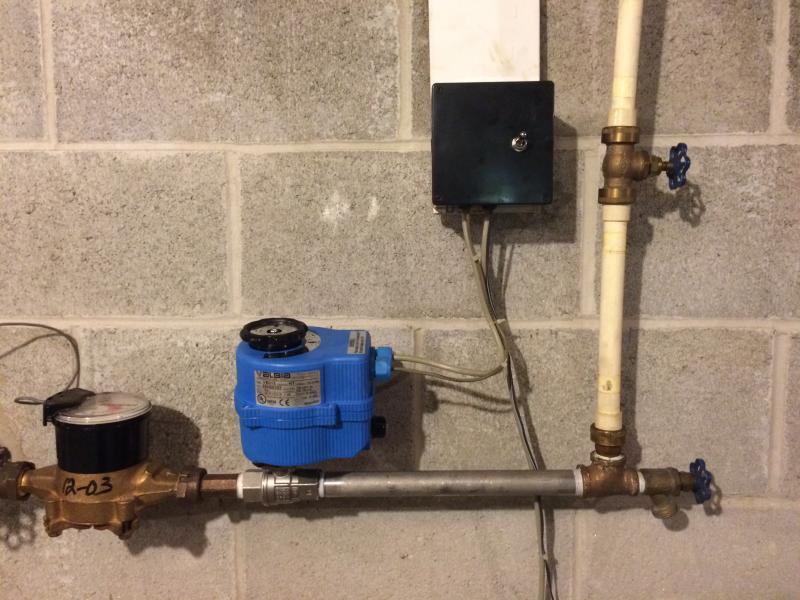

Glad you discovered it before it did more damage. I have wireless water sensors in all the "wet areas" to detect possible leaks. If any one senses moisture it shuts off the main supply to the house and sends me a text alert.
Here's the shutoff valve...
