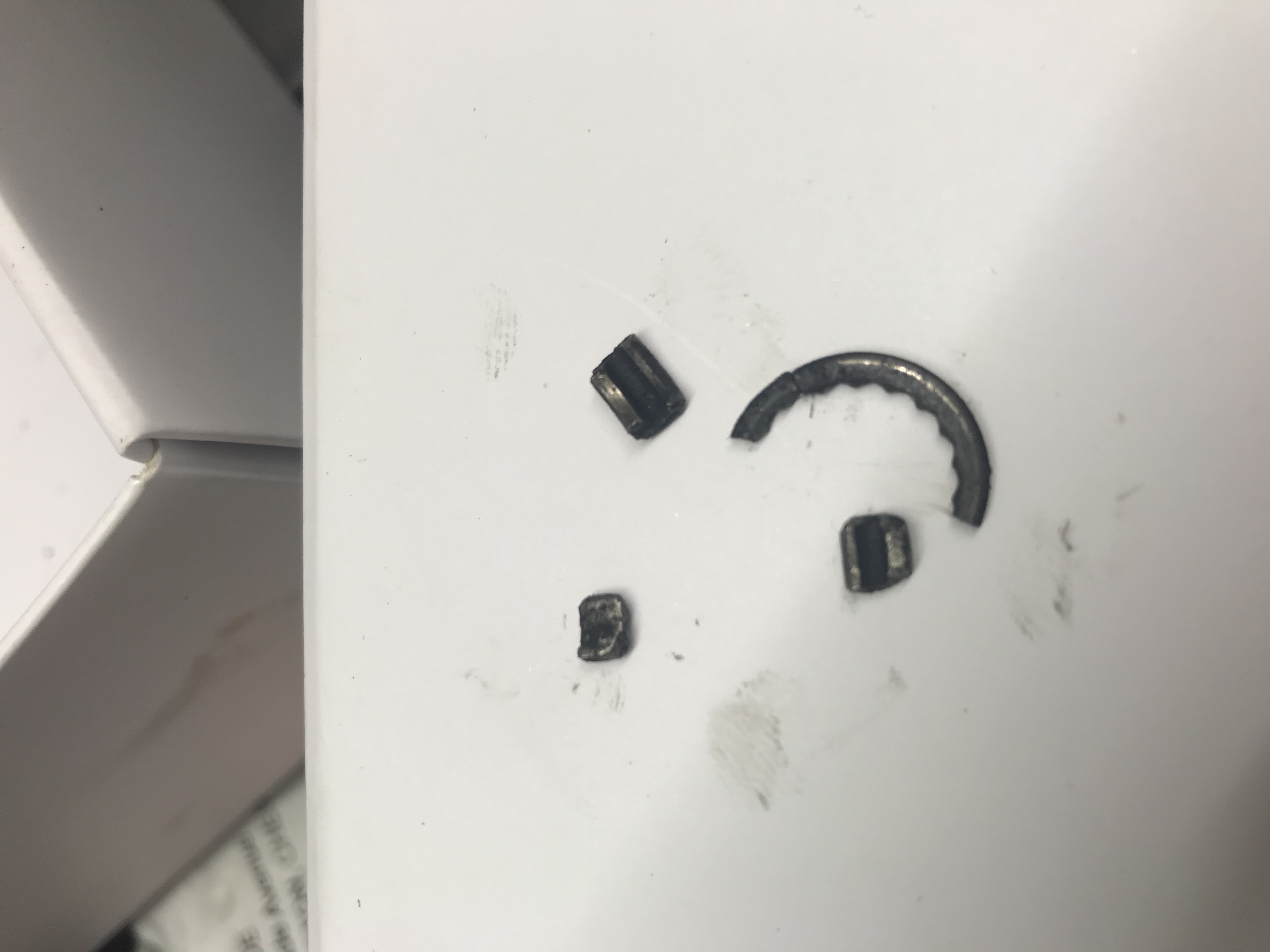

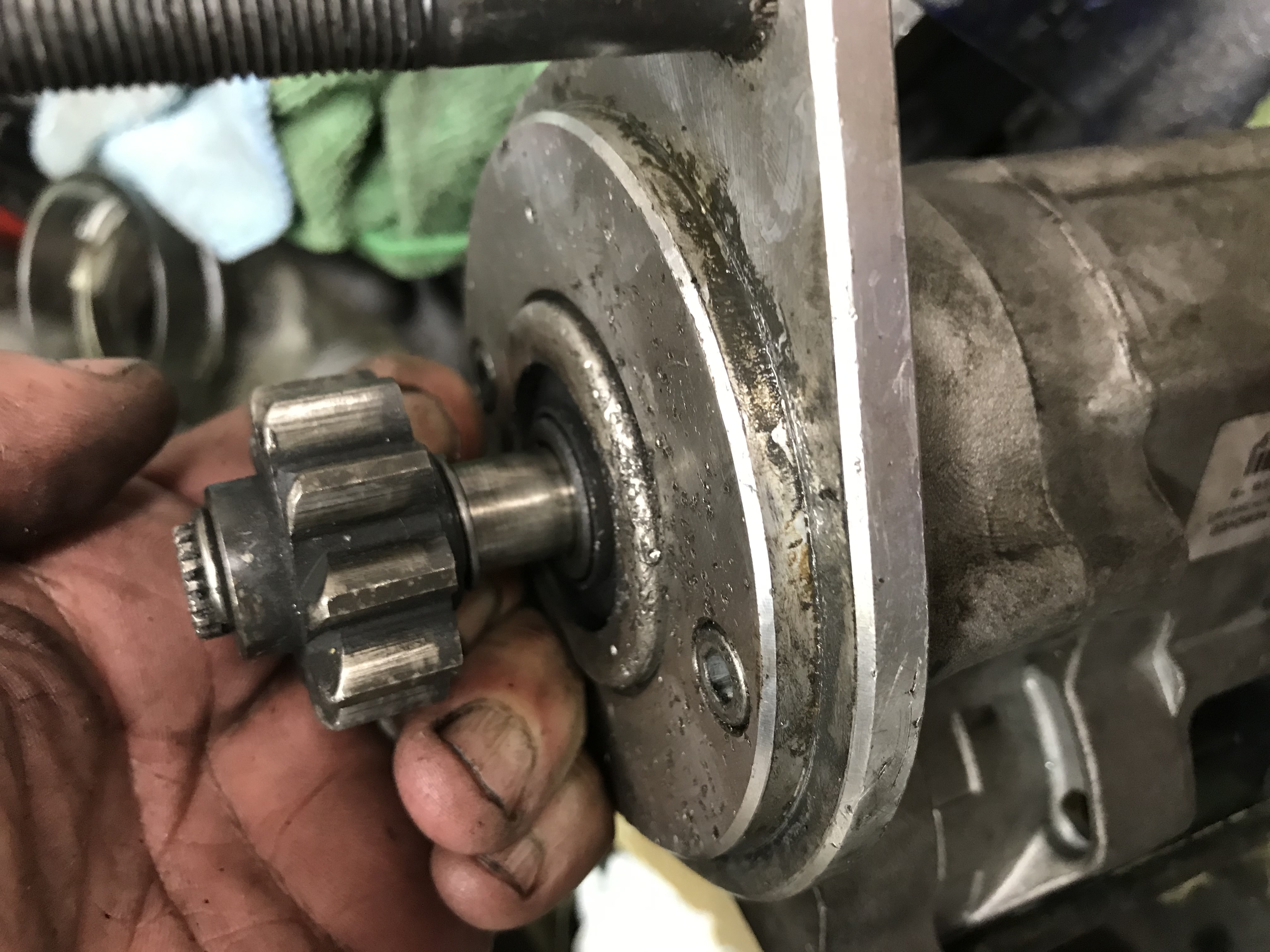

My starting guess is the pinion cog on the starter.
I had this on a hi-torque starter.
I'll have a look at that today. There used to be a good old school shop where I live that could repair starters and generators on these cars but it seems that it may be a lost art now.
