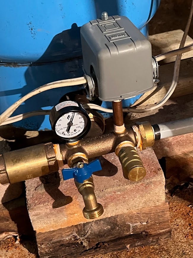

2. The pressure switch is this:
I am fairly certain the pressure switch is new. When it shuts off. (Tom as per your comment) It is indeed because the pressure is too low. I re-start and all is good. When I re-start I take the top off the switch box Bob so that I can see the contacts connect as I need to hold them there for a few seconds.

OK - trying to pull this all together - what do you mean " ... When it shuts off. (Tom as per your comment) It is indeed because the pressure is too low."
If you mean the pump shuts off, it should shut off when the pressure reaches its *high* limit - not a low limit. A pressure switch can only switch off a pump; the switch itself doesn't "switch off".

Even if you lose power, the switch does not need to be reset. When the pressure drops, typically to 30 psi, the switch should turn the pump on. it should turn off around 50 psi. Perhaps the adjustment is way out of range. I assume that you need to reset because you lose water? Plenty of youtube videos about the adjustment of the switch.
re-set is the wrong word.
1. switch turns off (completely) because water pressure is too low.
2. I discover this when I turn on the tap and there is no water
3. I go down to the cellar and use the little lever on the side of the box to turn it back on
4. Tap works again.
Just trying to sort out if there is a way to do #3 from inside the house and not have to go down to the cellar.

When my well runs dry, the pump continues to run continuously because it can't build pressure. The switch is suppose to shut the pump off when pressure reaches the set point (50 - 60 psig), and turn on again at 30 - 40 psig. What may be happening is the switch is not turning on again when you use the water and the pressure drops. My old pressure switch had a lever on the side so one could manually turn it on or off, but, IIRC, my newer switch doesn't. I only use well water to water the front lawn because the well water is too hard for anything else.
