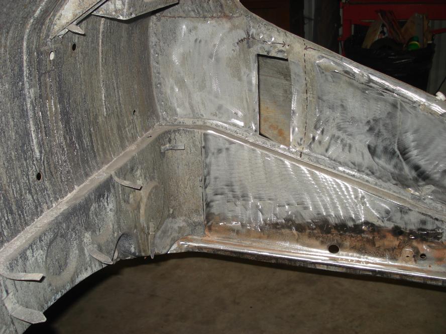

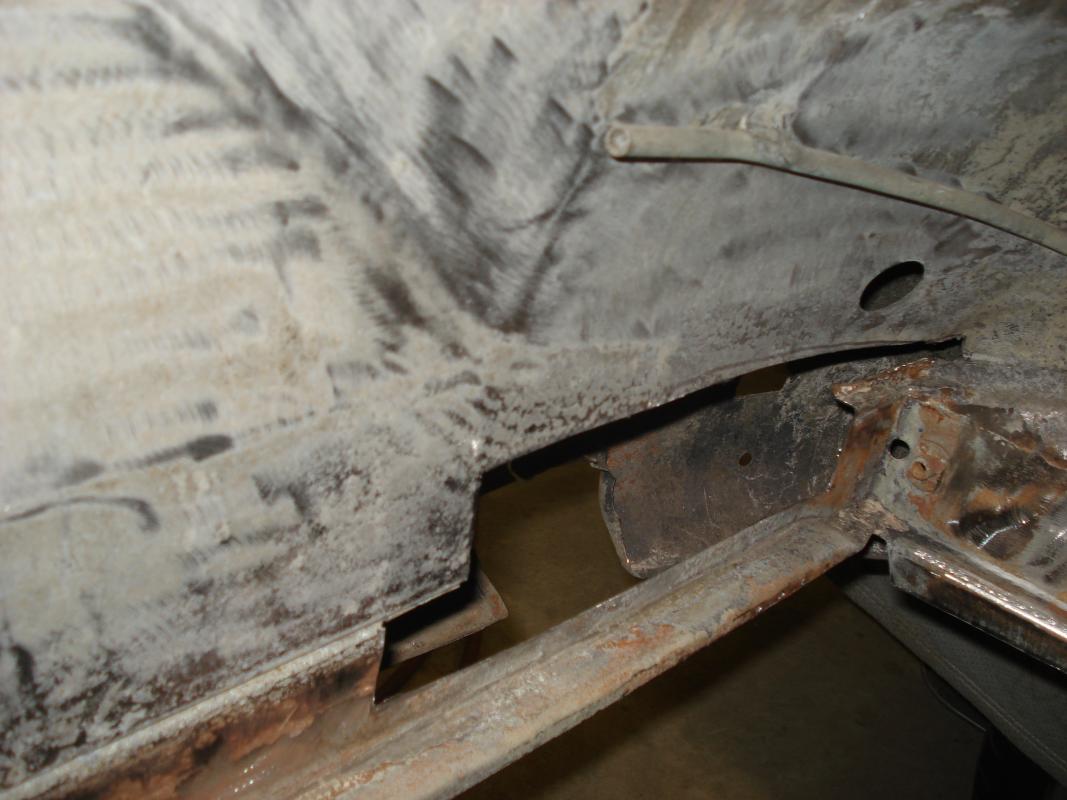

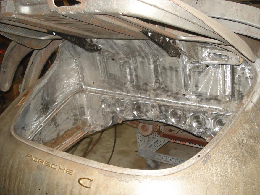

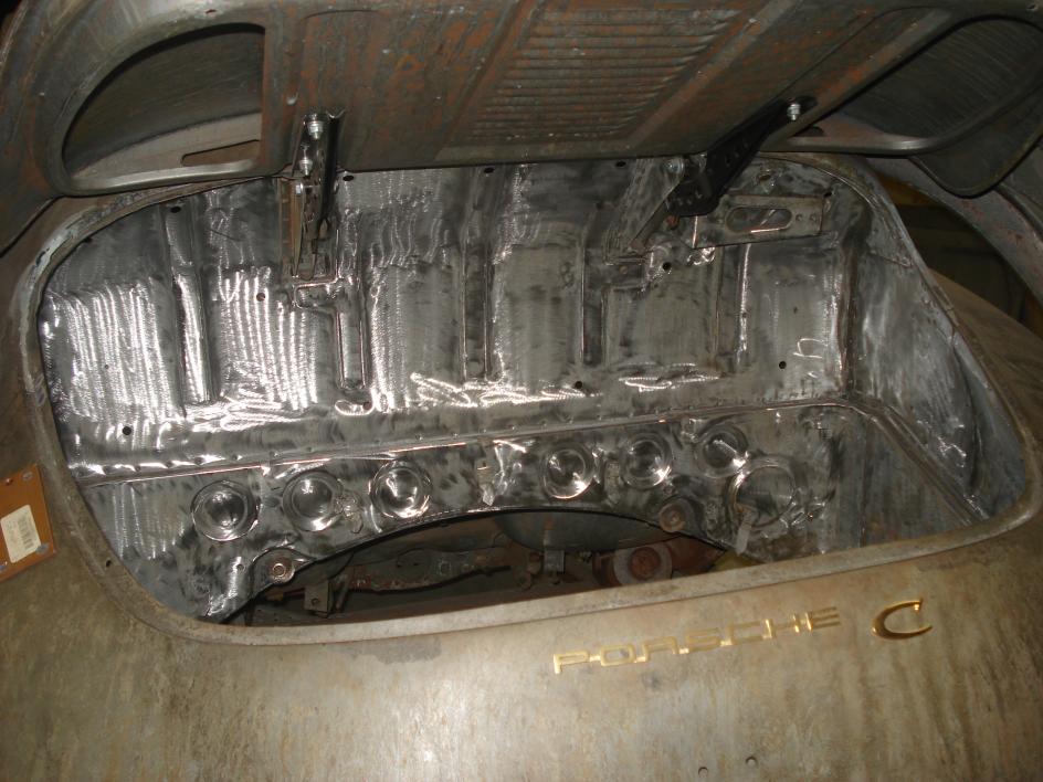

What'cha working on now, Jim? You know we're all fascinated with your projects :smile:
Working on a 1964 Porsche 356 coupe. I do a little at a time. Should be done with all the metal work by the end of the summer. Not my car, a customers car. Working on finishing up the engine bay and starting on the front end. I am replacing the entire nose sheetmetal, but first will be replacing all the metal behind it.

Yes, I can see that one keeping you busy. It's nice though, to work on cars you're familiar with; I'm sure you've perfected your skills with as many as you've done. It's like me and the Z3/Ms; I've done so many, I can spot the least little thing out of place__like the wrong fastener. I'm very critical of mechanics (especially bodymen) that've worked on the car before me, if they don't put everything back the way they're supposed to! Owner installed modifications are a mixed bag__can't be too critical, as they're the ones paying me ;)
I don't think any of your Healey friends on here would mind if you posted the ocasional "off topic" progress pictures of what you're working on; I think you have a pretty good fan-base here.
Re: welders
Like Randy said, would love to see more progress photos on the 356 C. Had a 1965 C Coupe and other than Healey's, my favorite car. Just let me at that project with my HF 90 amp flux mig welder and I could make it Swiss cheese with all the burn throughs in no time !
Re: welders
The 356 Registry is the place to see welding jobs! There seems to be dozens of projects that have MAJOR welding repairs. And they are not simple cars to repair. I take my hat off to them all.
