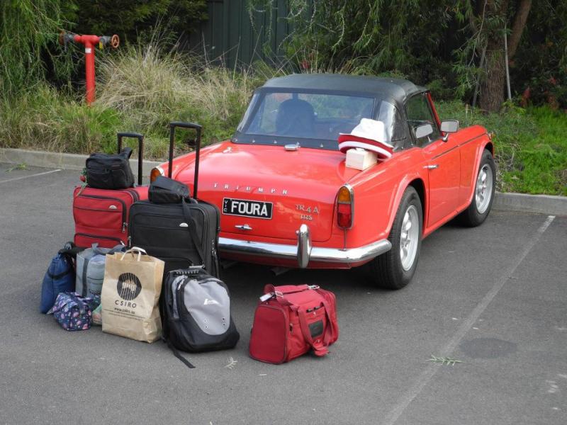

I run 195/65 tires but I have a 165/80 spare. Lighter and keeps the boot floor flat (see below!). Another possibility would be an alloy cylinder head. As with horsepower, lightness only requires application of money!
Here is why I won't be lightening the chassis any time soon!

Do they make alloy heads for 4 and 6 cylinder TRs? I know you can get them for the Big Healeys (and Spridgets and Bs too I think) but didn't know about the TRs.
No need to lighten the frame, judging by my exploits while replacing the trailing arm mounting crossmembers on my car, a bunch of the original factory frame weight has already disappeared into rust! :wink-new:
