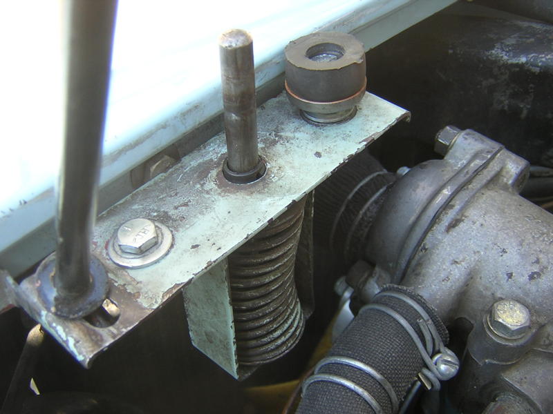

Aggravation #2: A couple of years ago, I even started a thread on this one -- bonnet rattle. I HATE the shrieky squeak produced by the bonnet push-up rod at idle. Replacing one of the bolts that holds the spring/rod assembly with a rubber pad helps to calm the bonnet vibration, which reduces the screechy rattle from a gawd-awful racket to a mere aggravation. By the way, I have found that the easiest way to do this is to use one of the same little bolt-and-pad assemblies that hold the bonnet up at the edge. I finally got tired enough of this noise to take the spring assembly apart, drill out the two rod holes, and install two nylon snap-in bushings. I DO know why I waited so long to do this -- it's a royal pain-in-the-rear to reassemble this bugger and get it back on the car. I spent about five minutes searching the neighbor's back yard for one of the washers that are at each end of the spring. It was about 10 yards from where it got away from me. This is an ENTIRELY WORTHWHILE MOD! Blessed silence at idle. There's still a little bonnet rattling noise, but the spring squeal is GONE.

Did anyone notice that wear mark in Moses picture? There is an obvious ring about half way down the post. Mine doesn't have a mark on it aside from the rust pits. Maybe the difference is my hood has been up much longer, the engine has never been run or it's so smooth that it doesn't vibrate at all.

Yes, there is a definite wear mark where the the rod <span style="text-decoration: underline">used to</span> rub on the top plate of the assembly. It's like fingernails on the chalkboard. I am SO glad I made it go away...

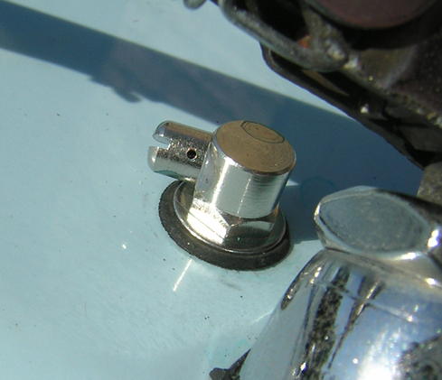

Mine rattles from the Dzus pins in the hood. I found this piece of plastic on my workbench:
which fit perfectly between the pin and engine side of the hood. I have no idea where the piece of plastic came from or how it got on my bench, but it works perfectly: no more rattles (from the hood).
