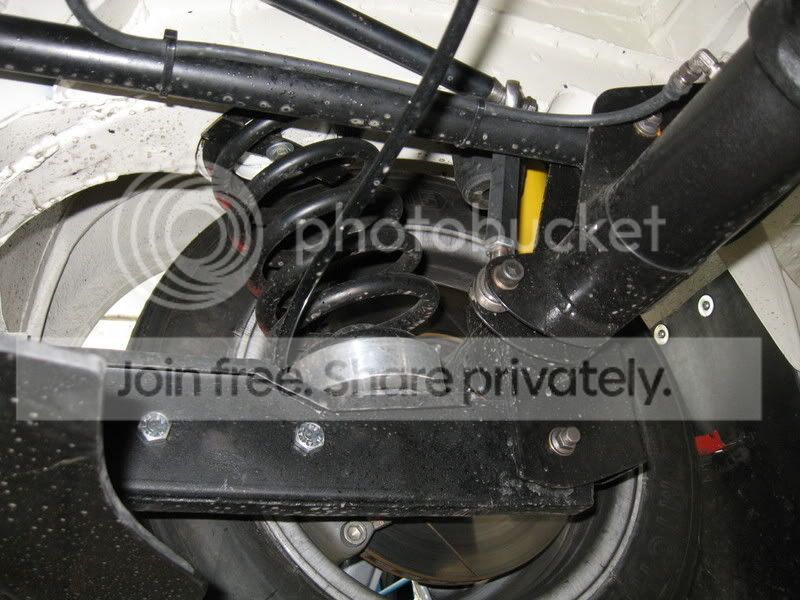

Note top strap:
Another car:
jclay
I don't see it. Just a sway bar link that goes over the axle. Of course there is a yellow bilstein shock, an upper and lower control arm, and a spring as well.
I like your suspension work. More than I want to do though. I see that you tied the springs to the frame rather than the axle. On my rangie I tied them to the axle.
The rally cars use the shock as their straps. One word of caution on this is the upper shock mount if the shock binds will push upward and tear out, but for most of us this is not an issue! For the rear spring the lower control arm has a tube about 2 to 3 inches in length welded to the arm to keep the spring centered. The upper mount of the spring has a strap running across the diamter of the spring.
