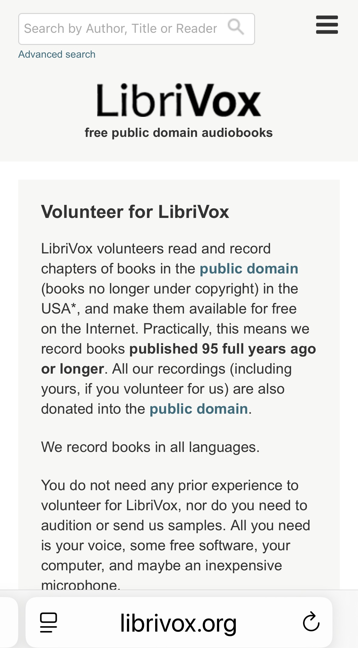

Would a couple BCF members help me test a website's access?
I'm interested in doing volunteer work for LibriVox - as an audiobook reader.
But their website is incredibly slow in loading pages, at least for me.
Could you try to reach: https://librivox.org/pages/volunteer-for-librivox/
And let me know how long it takes to load the page?
Thanks.

30 seconds for me Tom. Pretty slow. :rolleyes2:
super slow here also
The page booted up instantly for me. I tried it a couple of times. No issues here.
Thanks gents. Looks like a regional routing problem - not a website problem.
Thanks for the help.
TM
