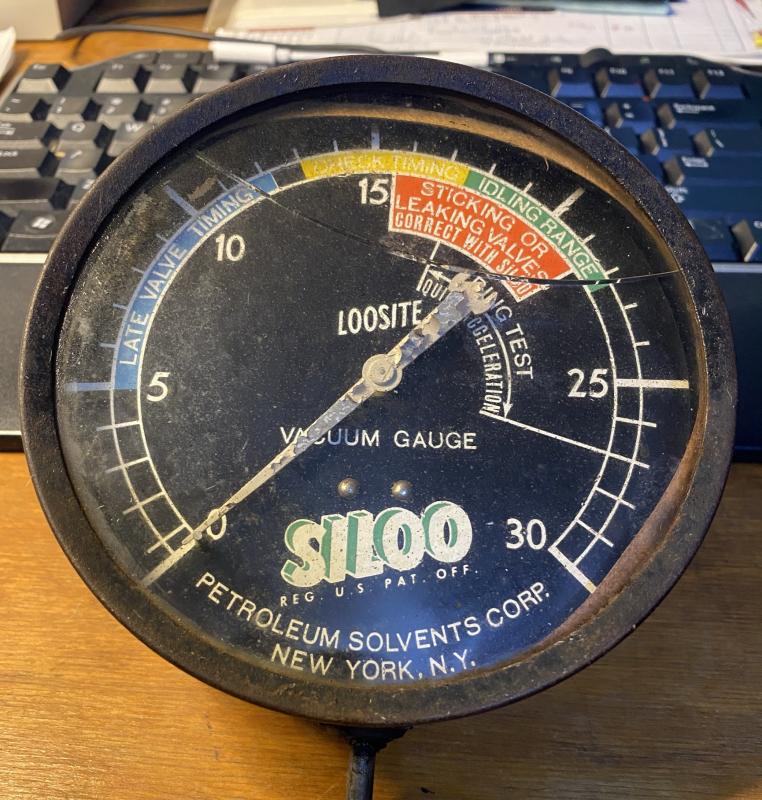

I was about to mention that vacuum is another means of setting timing, adjusting timing to right about maximum vacuum from vague memories of my 49 Chevy 30 years ago.
