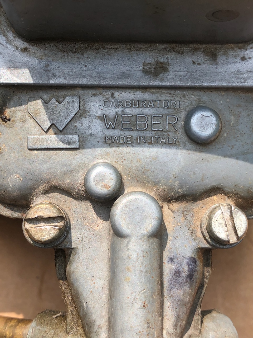

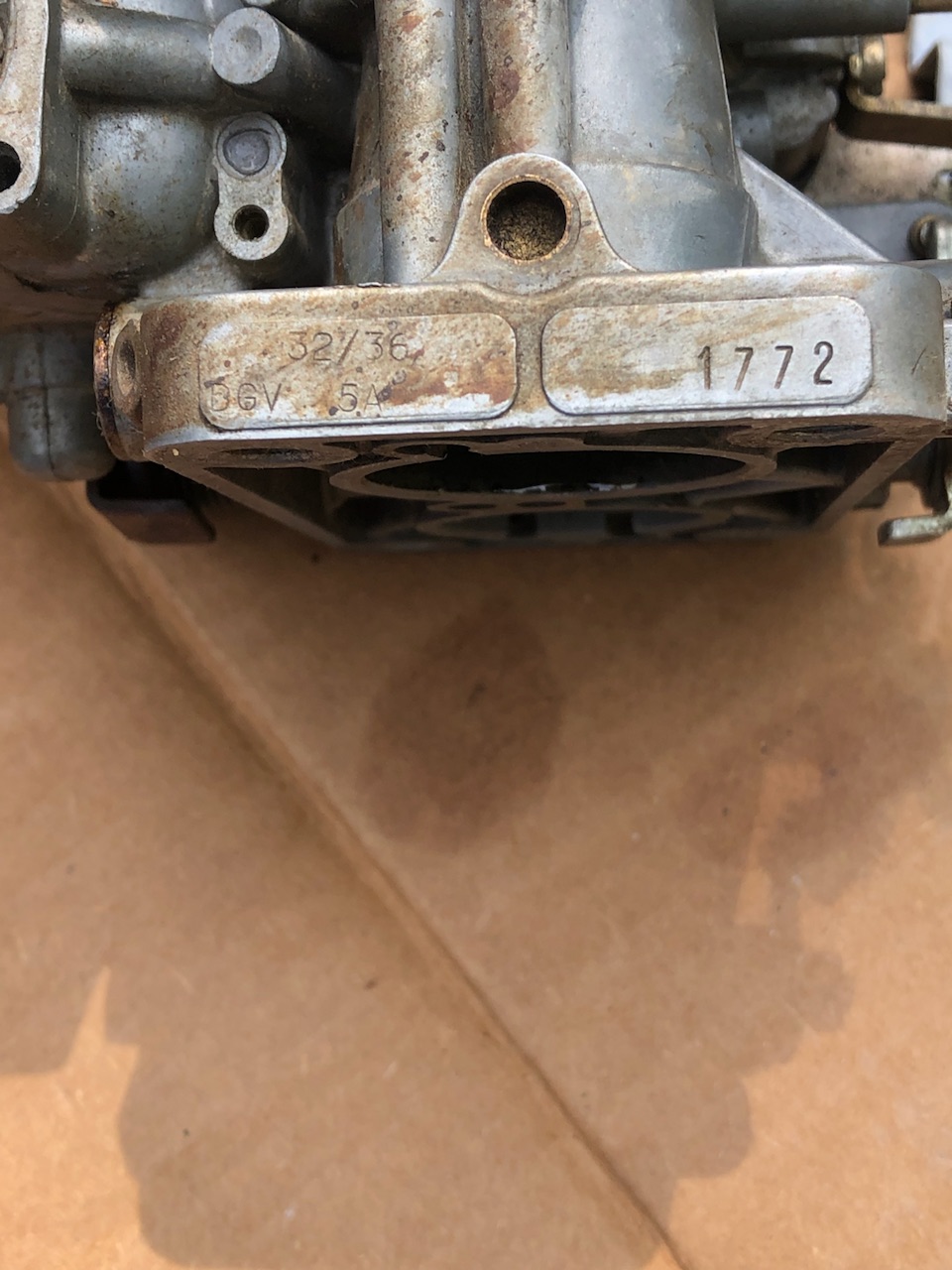

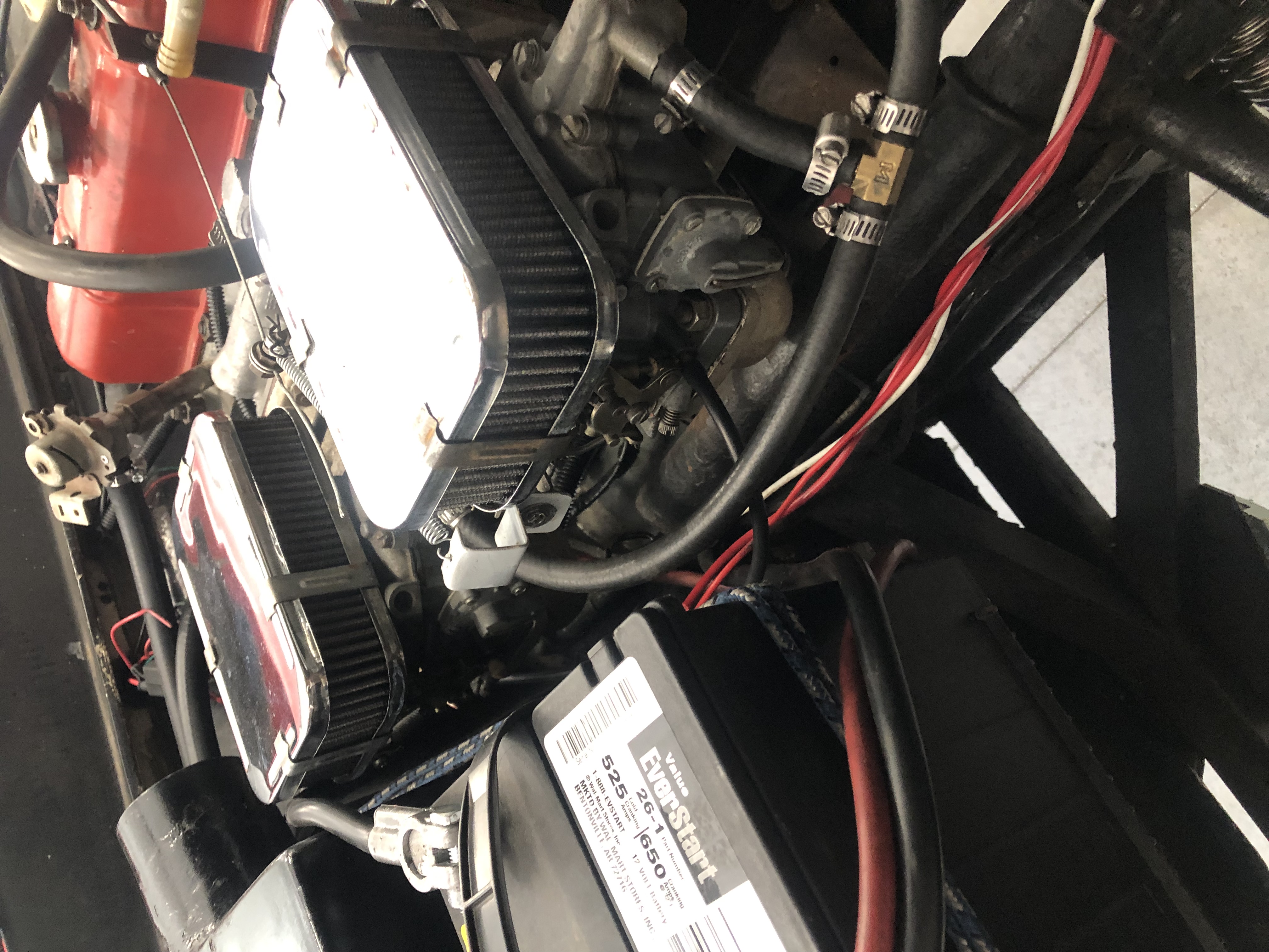

I’ve got a TVR 2500M.
It’s been converted over to a pair of DGV’s, on a Pierce manifold.
It runs pretty good when driving, but whenever I pull up to a stoplight, the car stalls. Also get a lot of backfiring when I let off the gas.
would like a little advice, I’m going to initially try to just pump up the idle a bit, but maybe there’s something I don’t understand about these guys. I haven’t really messed with them yet, only had the car for about a week.
I know there’s some Weber experts around here. Thanks.

Thanks, JH -
Appreciate the support! These are Italian Weber DGVs, 1981 build (they both have an ‘81 date stamp on the bottom). They are not going into the trash bin, I know that.
I’m away from the car until tomorrow, but will reach out if I have questions! When I took them off, and cleaned them up, they seemed to be put together reasonably well, I didn’t notice any obvious issues on the exterior inspection….
