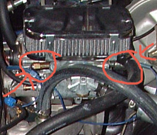

Are all the electrical connections working? The idle solenoids (I think that's what there called off hand see picture) need to have power. If they do not have power it will run like described or 1 or both the solenoids could have or are failing.
I checked them out. Lot's of good info but I'm really looking for is a description the different circuits and how they work together. THANKS. I'll give them a call.
