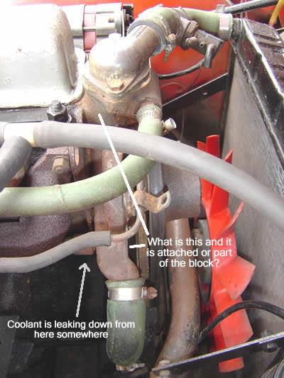

I have a picture now for anyone who might know where this leak is coming from. See the picture. I appreciate any help. Alec seems to think it's the water pump. I'm hoping it is since it doesn't seem to hard to fix. I also have a question posted on the picture since I have no idea how to describe it. Thanks!

Mike, the picture shows you water pump and thermostat housing and it does come off and you could have a bad gasket there but the most probable leak is the water pump running out of the bottom hole and in to the area you show. See if you can clear the bottom of the water pump real well, let it set for 15 minutes then stick a paper towel rolled up in this area, if you get green stuff, figure the pump if not get your gaskets, houston you have a problem. Wayne
Mike, there are 3 bolts that attach the water pump housing to the block. I had an identical failure last Saturday at the race track, when the gasket between the housing and the head decided it had had enough. It took 10 minutes to fix, and didn't even have to pull the radiator hoses. It was on a Spit 1500, but it's the same. If it's coming from further forward, it's the pump. But, that's another 10 minute fix to replace the pump.

Hello Mike,
where your arrow is, it seems unlikely that it is from the pump itself, if it were the water would be evident just behind the pulley.
It could be the main pump body to cylinder head gasket, or the union for the heater pipe which runs to the rear of the engine, or even the pipe itself, being steel it can corrode. It is also worth checking that the bolts holding the pump body are tight.
Whichever it is not a big job as others have said.
Alec
