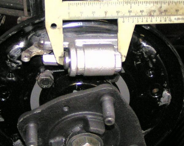

Ran into trouble when replacing wheel cylinders on a '67 MKIII spitfire.
1) As shown in the photo below, the fully collapsed dimension on the cylinders is roughly 45mm. When the drums wouldn't fit over the brake shoes, I discovered that the compressed dimenion of the old cylinders was roughly 42mm. In order to resolve the issue, I had to grind down (very slighly) the contact pads on the brake shoes.

They were probably rebuildable, but on small bore cylinders rebuilding is always a gamble. If I had it to do over again, I'd have the original ones sleeved.
