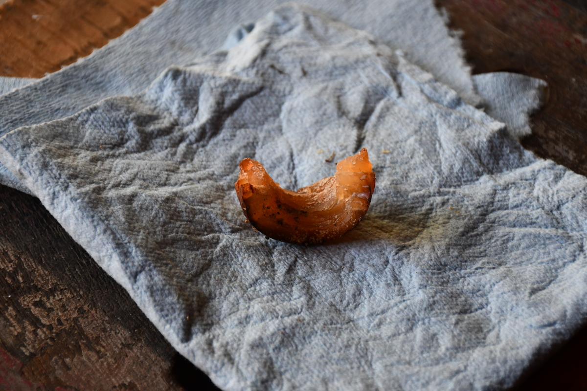

In the diesel cars before 1986 the accelerator pedal is connected to a pivot point on the firewall, secured with a "bobbin" in a bracket. The material of the bobbin is some sort of plastic and the part is now Unobtanium or NOS if available, and sold at outrageous prices. Yesterday for the second time the bobbin in Diesela disintegrated and the car would only slowly get to 30MPH. After the first one failed in about '98 I substituted one of Mitsy's wood beads for the part 'till the replacement was bought, available then for around $20. Yesterday I MacGyver'd another two wood beads to serve until we can make a better part from nylon or some other long lasting material. At least for now the car accelerates as well as it's supposed to.
What was left of the second OEM replacement part.
