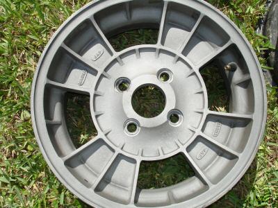

Another one. Here is a JA Pierce wheel for the TR. Don't see many of these around though. Think they were magnesium.
Isn't that what Geo put on his TR4?
