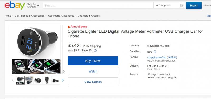

I wonder if that could be modified/adapted to just slip into the cigarette lighter...?

I like my Smith's "Battery Condition" voltmeter available reconditioned from sources in GB for around $120, but can understand why one would want one of the above for around $10 -- even if you had to wait a couple of weeks for the slow 747 from China.
