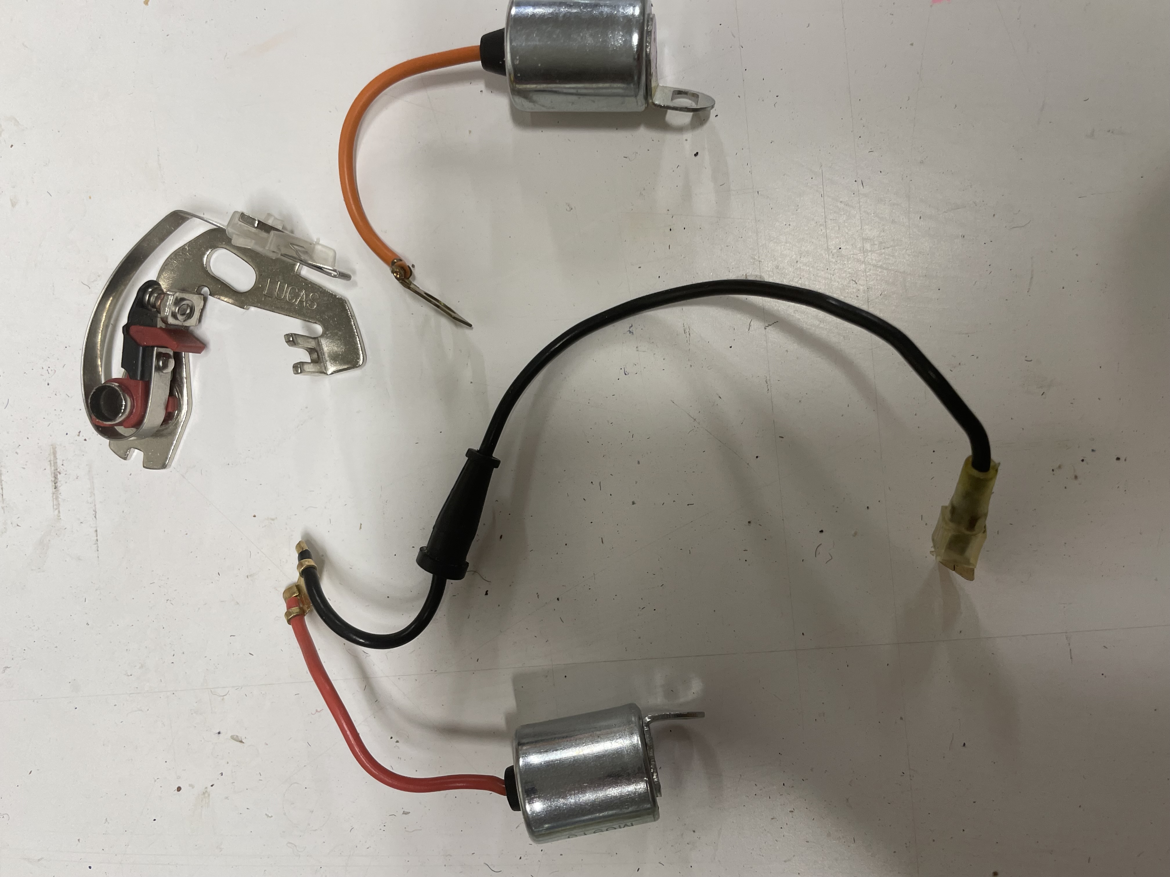

My points use that new MGB type clip for the condenser. No more insulated nylon ring and tiny nut on pole. The coil wire and condenser wire are tied together, and then slid into the points frame where a clip is fabricated. Weird but OK. But to test another condenser is a hassle unless I order the whole piece—HT wire, condenser, etc. I’m wondering about the approx ten extra condensers sitting in my shop. Would it be a sacrilege if I just cut the wire on the new setup and soldered and heat shrinked an old/new condenser in place of the new ones, maybe just as a test. I’m just saying the old condensers attach differently, but I could see finagling one onto that clip in the new points setup. Hope I’m making sense.
Here is a pic to clarify my question. It would be a shame if I couldn’t use any of my old style (unused) condensers. As you can see, the new one for my distributor is a package deal with the wire to the distributor. But I guess I could cut and solder. Or, jam that o-ring connector into that same clip on the points rail. Doesn’t seem it would be all that secure.

And, stating the obvious, based upon the stalls and non-starts over the last six months, all in the same vehicle, if the problem was, in fact, the condensers, that would mean that in each case it was the condenser from this new point set up (attached and soldered to the distributor lead), which, as I am told, is the latest issue for MGB vehicles, adapted to Triumphs.

You can't test an ignition capacitor in any meaningful way with a multimeter. That's clear. They operate at high current and voltage, much higher than what a multimeter uses. Here's the result of my study into the cause of capacitor failure: https://sprite.nonlintec.com/cap_failure/. I think you'll find it eye-opening.
There are condenser testers in some multi-meters...but it is not a common feature. I also have several Tektronic testers that check condensers...or rather capacitors, which are the same thing. Even then, I do not always trust the results. Auto condensers are subject to extreme heat and vibration that can't be duplicated during testing. I figure there are 2 failure modes for a condenser:
First is if the internals short, essentially making it a short circuit from the case to the center post. This would never allow the coil primary wire to open, so it never collapses it's magnetic field. Of course the short may not be complete, in which case the engine will run, but the coil will not generate full strength, since most of the energy is being taken by the shorted condenser.
The second failure mode would be open circuit. In this case it would be like not having a condenser at all. The engine would run great...for a short time, but every time the points open, the collapsing magnetic field at the coil will back feed the points with hundreds...or even thousands of volts...which jump the point gap every time it opens. In short order this high voltage spark will burn the face of the points, so they no longer make a good contact when closed. The end result is a car that starts running poorly and gets worse until it will not run at all.
All I can say about your 10 condensers is...they are really cheap. Toss them if you have any doubts. It's not worth the frustration for $3-5 a pop.

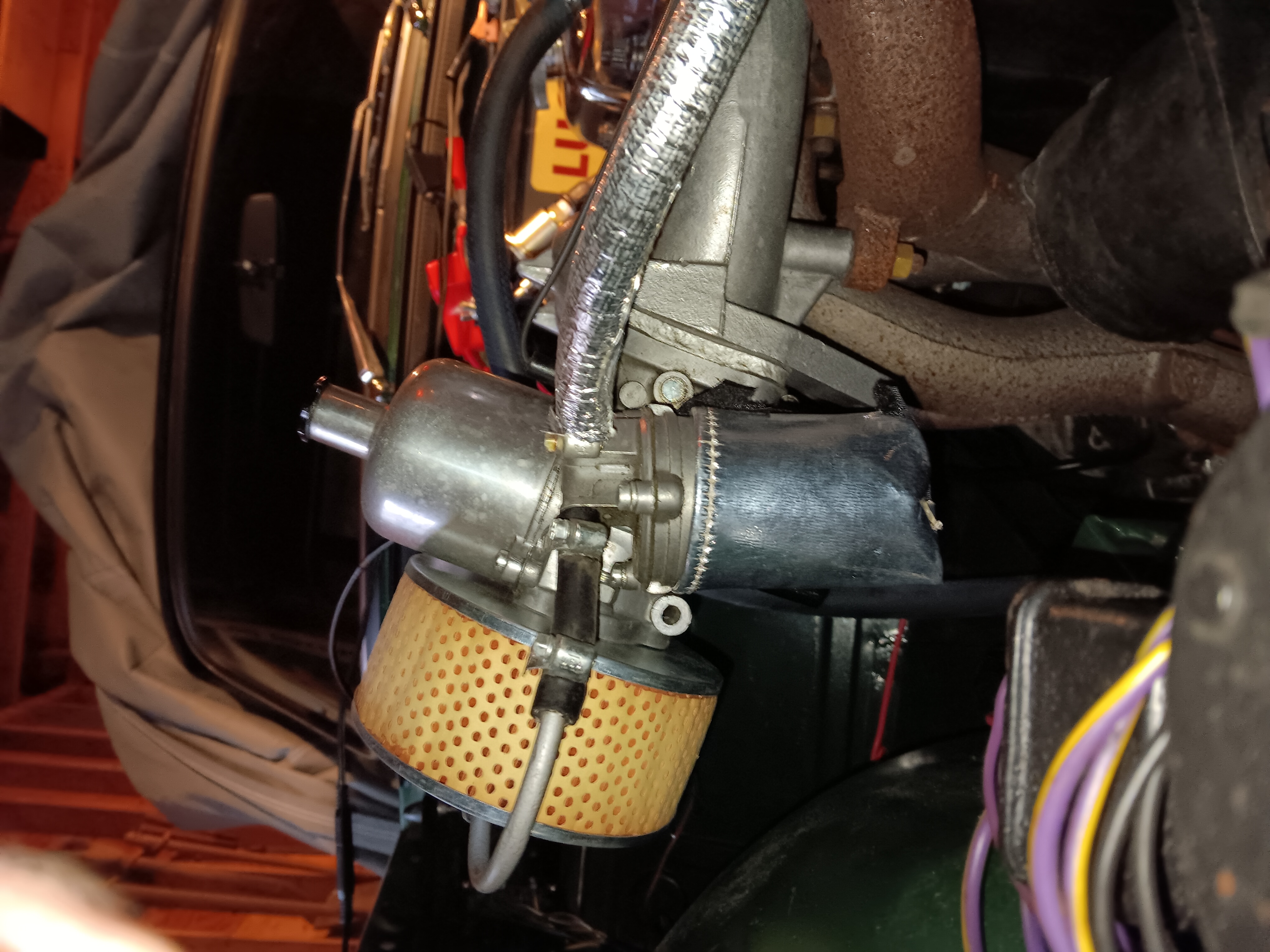

Guys, I’ve overlooked something glaring. It’s 105 degrees here, and I go driving right in the peak of it. I just do.
The fuel is getting hot. I see it bubbling in the fuel filter. I have many sources of heat: My dual mufflers span outward and one pipe is within an inch of the fuel line for several inches, and within five inches for another foot.
On top of that, the glass fuel bowl on the fuel pump gets extremely hot next to the engine, and the plastic fuel filter up near the carburetors gets equally hot. From what I am reading, these heat sources would be sufficient to begin vaporizing my gasoline inside the fuel lines, and this would explain the great difficulty I have restarting the car after turning the ignition off.
I know it sounds like a rationalization, but once I stop the car and fresh fuel is not running through the line, the fuel that is in the line is probably boiling at an even faster pace.
All of this would explain why nothing that I do makes any difference. Tuning, timing, fuel mixture adjustments, ignition details – – nothing matters. As several of you are saying, it probably is fuel after all.
I’m going to focus on heat shields, foil and heat shielding tape. I may even run over to a muffler shop and see if my exhaust pipes can be reshaped.

This is a doozy. I am still on the fence if your issue is fuel or ignition. The fact that it still would not start after 9 hours of cooling but started as soon as you swapped dizzy makes me still think it is ignition related. If it happens again after 9 hours of cooling, I'd be tempted to give a bit shot of starting fluid into the air cleaners and see if she fires.
Been down the road of fuel vapor lock (in the fuel lines - leads to fuel starvation) and percolation (in the float bowls - leads to overly rich mixture) before. If the float bowls are purcolating, you will get a heavy gasoline smell uner the hood - this was me. For me, it only happens in very high ambient temps when idling a long time at a stop light, in stop & go traffic or if I shut down and try to restart w/i 15 mins. But, neither should impact you when driving at speed (with lots of air coming in the front end and fuel constantly moving through the lines).
In Connecticut, this happens to me maybe once every other summer. Did not want to go the route of full carb shields. So, I removed my plastic fuel filter and wrapped the fuel line from pump to carbs in heat reflective wrap. I also bought some float bowl koozies from Joe Curto (photo attached) - not on his website, had to call him. I don't think today's E10 fuel helps either. My car idles at 650 RPM so now, when stuck in slow traffic, I will pop the hood to allow some ventilation to the engine compartment and pull the choke ever so slightly to raise the fast idle to 1000 or 1200 (but not to the point the choke engages). This does three things: 1) speeds up waterpump, 2) moves more air via engine driven fan, 3) keeps new/cooler fuel moving through the lines
Last, I am still looking at where my ignition timing is set and possibly having my distributor and vac advance unit rebuilt. I am pretty sure I am at 4* BTDC and my vac advance is not working right. If not advanced enough, unburned fuel will exit into the exhaust manifold on the exhaust stroke - driving up exhaust manifold temps and, thus, underhood temps.

I suspect that the problem is a mix of items and that I am getting closer by trial and error. Today I’m installing an electric fan and I’m adding heat shield material at the fuel pump and fuel filter. I also reinstalled an old ARE heat shield for the carburetors.
As an aside, I might mention that a little over a month ago I replaced the fuel bowl needles with stainless steel (brass?) ones having that tiny spring button at the bottom and no viton tip. I was concerned that the viton might more likely cause a sticking problem, and I felt more comfortable going back to the straight old-fashioned steel tipped needles.
