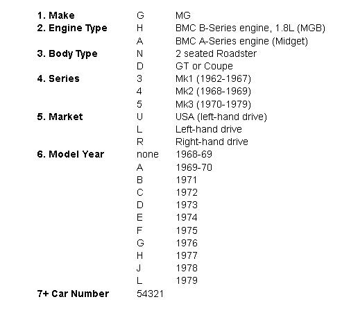

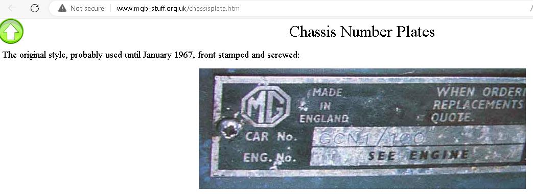

Also found this here, > Chassis Number Plates <, very interesting page all about vin plates

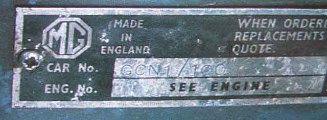

The original style, probably used until January 1967, front stamped and screwed:
The British Motor Museum says my tag number is fake and it should start with GHN3U, the attached tag starts with GCN1. Is there a rare chance that a 1966 MGB could start with GCN1 and my tag number is:
GCN1/41164
I know that it does not match the protocol of GHN3U, but the tag below gives me hope.
